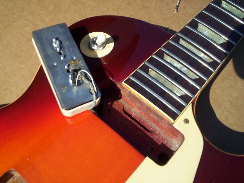

Hi, I'm sorry to hijack your thread. As I said in the other thread, I got a hand of a 73 Les Paul. At least I got told it was a 73.
The serial number is 1305xx
When I tried the serial number calculator I got this:
Your guitar was made at the
Kalamazoo or Nashville Plant , USA
approximately in: 1970, 1971 or 1972
some info about the guitar:
Les Paul Goldtop, no headstock volute (It doesn't lookt that way from the pictures,
but it has had a headstock repair so the pictures may lie?) I don't think it's a sandwich
body, it looks like a 1 piece back, and one piece neck.. it might be a 3 piece neck.. hard to tell. And the p-90 was standard, it's no holes after the mini-humbuckers.
The serial number is stamped into the back of the headstock, together with Made in USA.
