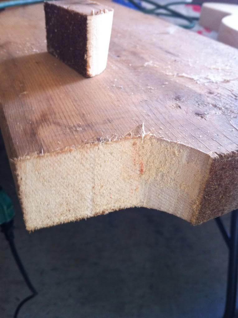

I found alot of this wood in a shed near my house. It's been in my family for along time and its been sitting a good while. It's a white/ yellowish wood and I was wondering what it was. I have a ton of it and was thinking about using it for a build. My guess is pine of cedar. Here's a few pics.

Some kind of pine, don't think it's cedar, too pale.

The smell while working with it will be a dead give away. The grain looks more cedar-ish than Pine and Cedar can have a wide range of colours from pale yellow to chocolate brown.

i agree that it may indeed be any of those mentioned, but it may also be fir. douglas fir in particular was used for general construction quite commonly in years past, though not as much recently. i also agree that the smell should give a hint. pine smells like...well, like pine (how profound is that?) fir to me has a tendency to have a faint waft of something less pleasant. ---wet dog, dirty socks...i dunno, but it makes a nice body if you don't mind it being a little soft. i'm working on one now salvaged from a bench i took down in what is now my inside guitar room. it's light.
i say use the doo-doo out of it.

yep looks like - SPF building grade lumber to me. Although there is some pinkish tones there that would suggest cedar. The smell will definitely give it away. Cedar is very aromatic. (sp?)
that is great test wood - make a couple bodies and some necks and fiddle around with your tools. Go fast and don't worry about making mistakes. I have done a test guitar for 2 builds and I am way less apprehensive to get going on those and then that shows me what "to" or "not to" do when cutting the more expensive wood.

I was thinking tele. It's local to my area and was cut from family property that I hunt in I believe. Unfortunately the thicker pieces have become termite male but there are probably 50-100 long boards in there! If I glue enough of them together I can have a decent blank I think. Another thing I've noticed I'd that it chips easily. I'm not sure if he boards are all of the same wood. Ill work on it some tomorrow and let you guys know what I find.

Well I found a huge board. Cut 3 16 inch long prices, sanded them and set them up to glue together. Part of the board is warped but I used prices that were pretty straight. Found tons of wood down there. We will see what it leads to but for now here's some pics.

So I cut out the body today. Still needs sanding. Gonna wood fill the gaps in the body where I glued it together since I didn't sand it flat enough to start with. It also has some worm holes.
I'm thinking something like this
or a snakehead tele.
Not to bad for old warped wood!
It's also really heavy! Any ideas on how to lighten it up?

I hate to be the bearer of bad news but your going to have some stability issues with your boards oriented that way. The grain needs to be oriented so it's parallel to the strings, same with your joints (there are exceptions to this but for your first you really should stick to the recipe) there are a lot of first time tele builds happening here.
As for lightening it, one option is to use a forsner bit to hog out some of the top and then put some sort of cap on it. Another is to do the same thing from the back, there are different considerations for both but I'm sure more folks will chime in when you get to that point.

Thanks Chris. I figured that would have to be like that. I was planning it that way but I cut it to short. Good news is I have plenty more wood to use. Was building it to practice in anyways. I'm going to order more tools today so I can resume in my jr. I think one build is enough for now! Haha
