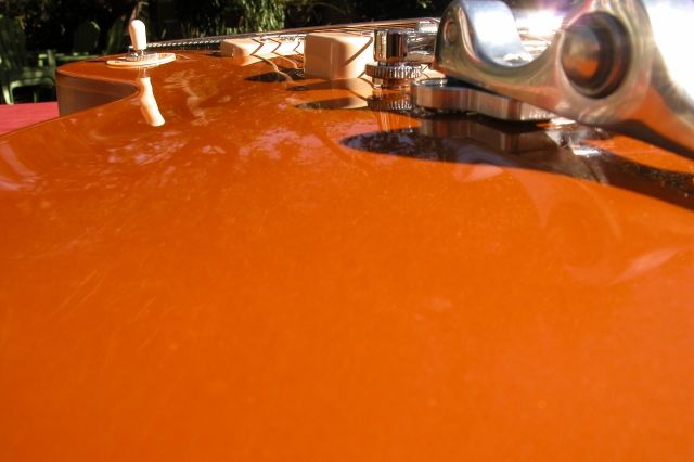

I progressively went up to 2500 grit and after it cured well, I used 3m scratch remover and didn't even have to buff. Finish looks great.
GrouchyDog
Mar 8, 2008
2,542
1,044
FM, that looks great! If Gretsch built a Les Paul that'd be it - nicely done!
