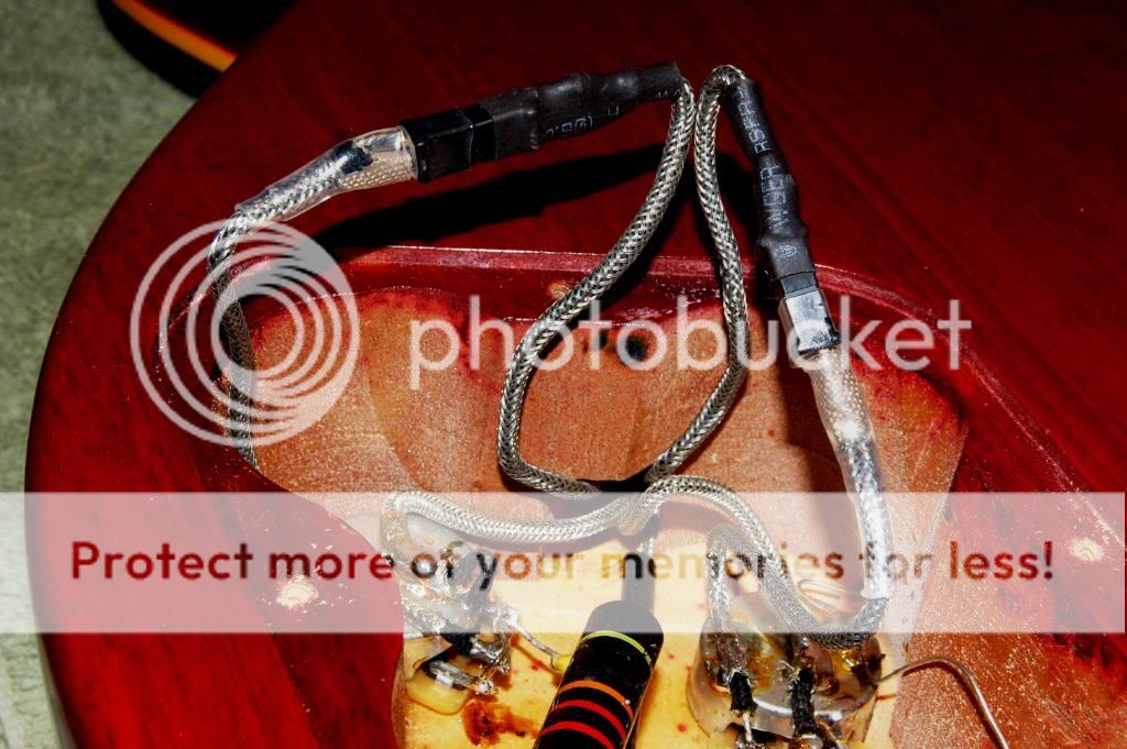

Member Quill and I have done this for quick pickup changes. We catch a lot of flack for it, but we're glad we did it: http://www.mylespaul.com/forums/pickups/69938-quick-change-pickup-tip.html
