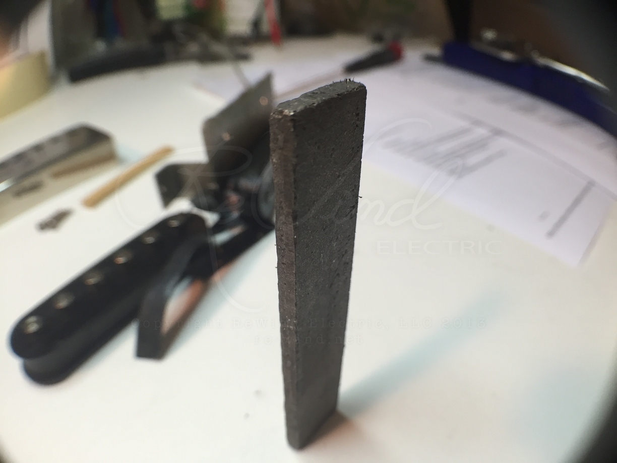

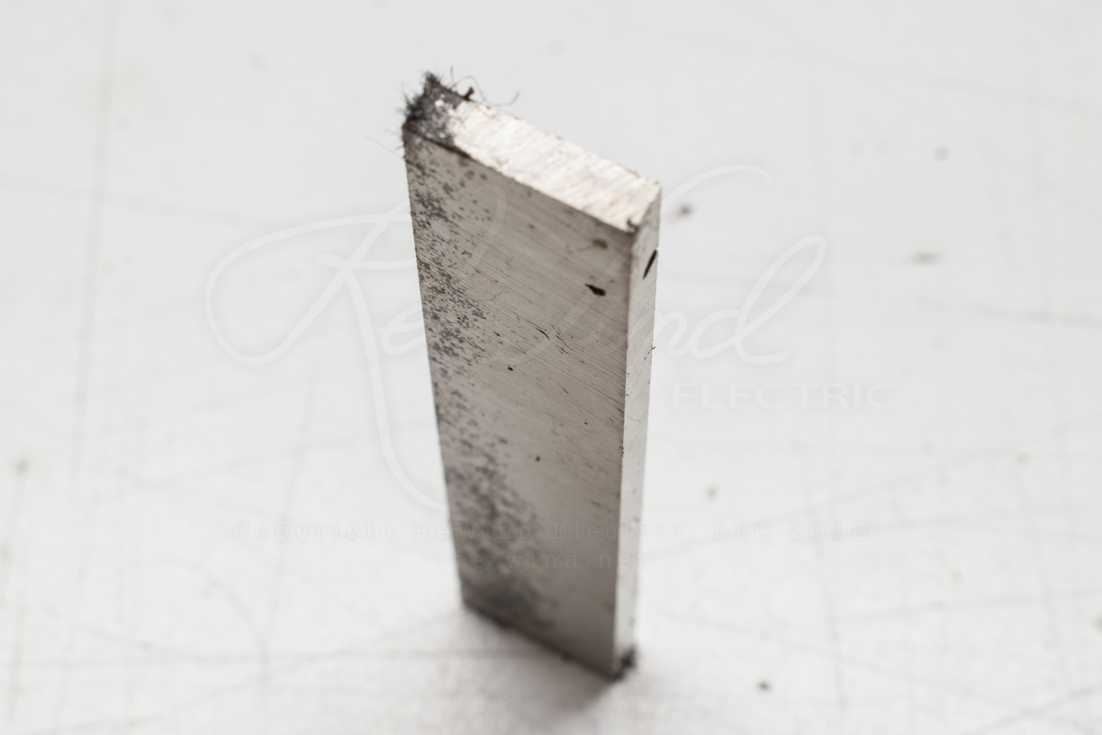

Here's a 1960's Gibson "rough cast" magnet:
As you can see in the one above, some of the magnets had to be ground pretty aggressively on all sides (even the ends) to reduce the size to spec, leaving the surfaces nearly perfectly smooth. This is an extreme example, and not the average look, but many are like this.

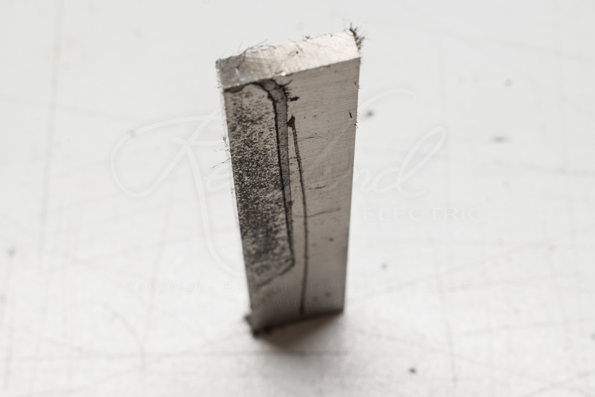

On the other hand, you can see some magnets like this from a very early No-Deacal 1957 PAF were not ground flat on the North polar face at all, as they were originally destined for P-90s where this side made no contact.
