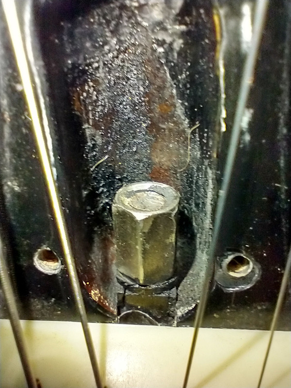

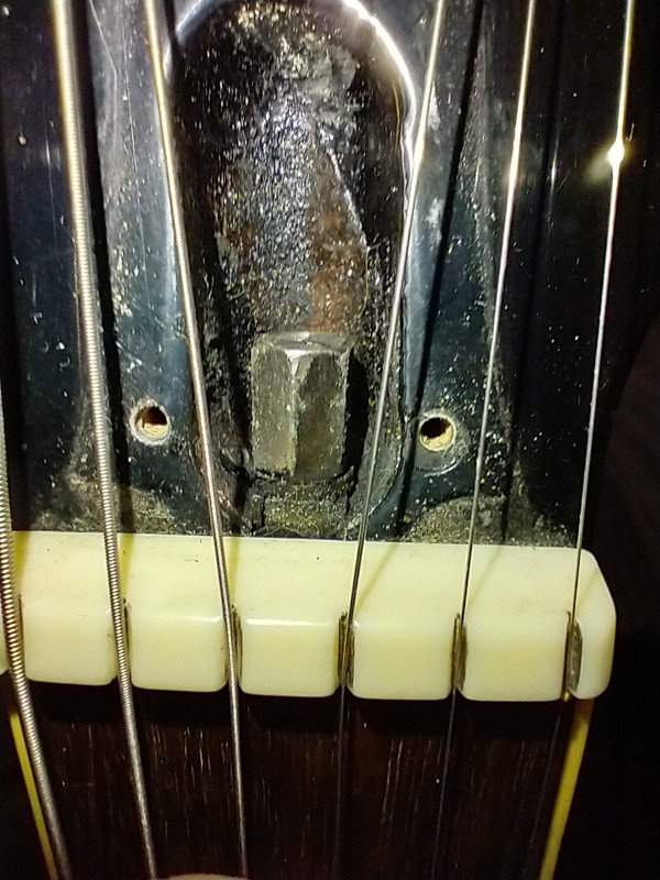

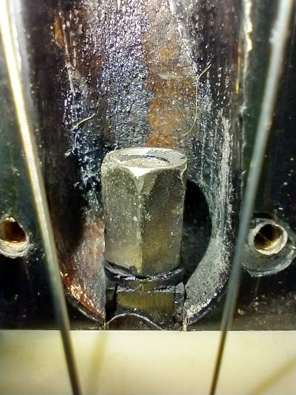

Can anyone help with what's going on with this truss rod? 90s Epiphone Les Paul classic. Made in Korea.
I assume this isn't from the factory. The rod sticks out and seems to not be a typical truss rod that takes a hex/Allen wrench.
Can I adjust this rod using a wrench? Not sure a sock wrench would even fit

Yes, completely factory.
Small socket, 1/4" drive, with a handle. No problem.
What would be the proper tool, is this:

Thanks guys. I feel a little silly (but relieved) for not knowing that is factory. I'm new and the other truss rods I've seen are recessed and take an Allen/hex.
Good to know. I'm thinking of getting this and the only issue I really had looking over it was this truss rod looks so different from my others. Just wanted to make sure this wasn't a repair

Didn't know Korea was on Imperial units.
I'd say 11 just from the pic, I doubt it's that big. The last Korean guitar I worked on (not an Epi, but likely made in the same factory) was an 8mm nut.
