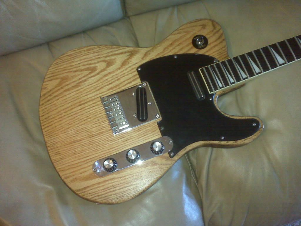

OK, update after some progress and some set backs
Got the rest of the holes drilled, neck mounted (came out super tight fit :thumb:) which was great
What wasn't so great was finding out my drill press is a about a hair too small to get at all the holes I Needed to drill for the ferrules and string through for the bridge. A slight challenge as I've been spoiled by the drill press, but I managed.
The biggest rookie mistake (or simple fever induced dumbassness :hmm::rolleyes:) was not to recheck my center line (with neck mounted) before mounting the bridge. Consequently when I first strung it up it was off enough to have the high E string right at the edge of the fingerboard. :wow:
Plugged the holes last night. Sanded everything nice and flat this morning, centered bridge properly to the neck (duh) and got it strung up now.
Need to get a chrome locknut (since the only one I had in the bin was gold). Anyway, time to disassemble everything and get some clear squirted on it. The only thing I'm not sure if I'm going to do first is wire it up and plug it in to check it out before giving it the clear. Football day today with the Packers hosting the Vikings, so not sure how much more time I'm going to invest in this today

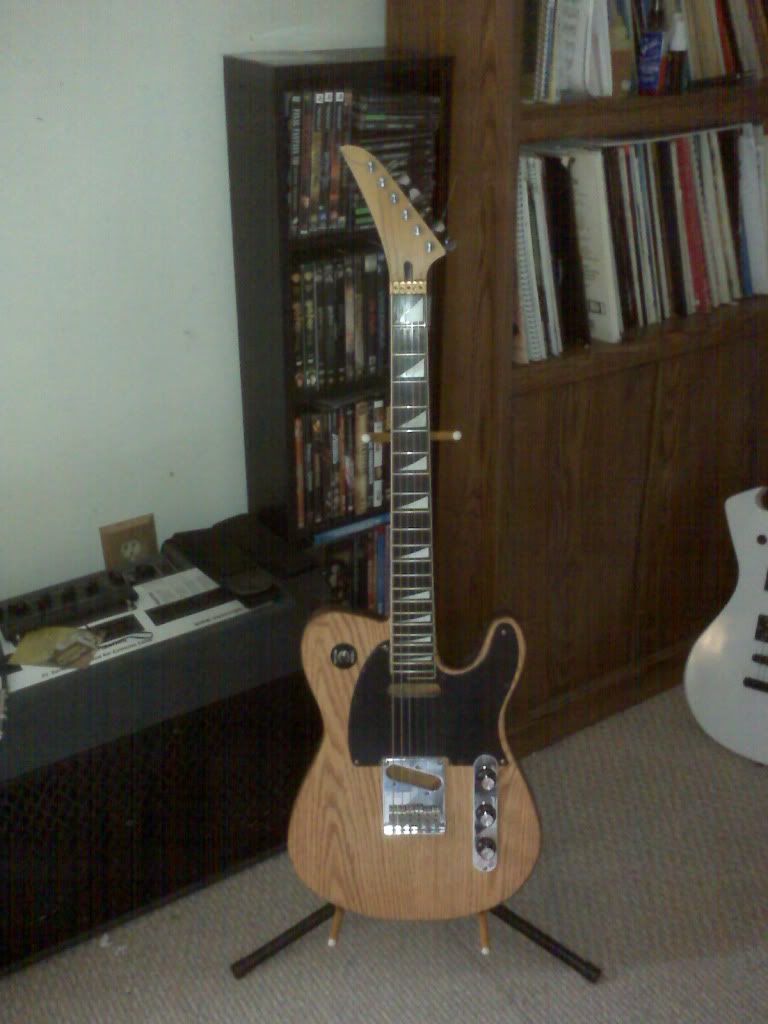

Looking Good!
Are you going to put anything on the headstock?
I've been fiddling with a "logo" idea for a while. Keep going back and fourth between two ideas. 1) C3 Guitars (Chris Cote' Custom) or 2) Wolfs'Tone Guitars (since for years most of my friends have called me "the wolf")
I also thought about adding an oak veneer to the headstock and giving it the same "burnt honey" finish.
But in all honesty I'm waiting to plug it in and see how it sounds before deciding how much "extra" I'll put into it :laugh2: It was an experiment with wood, and I haven't heard much good about oak. Strung up I was pleasantly surprised at how loud it was and seemed to resonate forever. Def seems like a keeper, but at the very worst, the oak matches my living room and will make one hell of a wall decoration:dude:
Right now its on its second coat of clear, doing some of the wiring as well

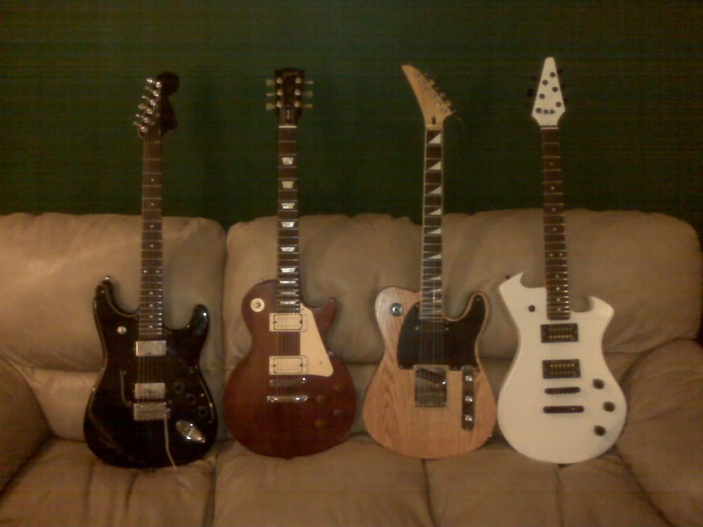

Joining the rest of the herd of guitars with the selector switch in the right place :D :dude:

Looks awesome except for that poker chip! The oak headstock veneer would look great too!
How does it sound?!
C Squared
Jul 19, 2008
7,036
4,141
How does it sound?!
Thanks man!!!
I Like the poker chip personally:thumb: And I'm thinking the veneer is def gonna happen when I do the nut
Soundwise: A lot of sustain, huge low end, some good highs, but the midrange is a little lacking in all honesty. If you're one of the metal players that scoop the mids right out of the eq, then this would be the guitar for you. May just be the pups that I have in it (GFS rails) and I want to get a bone nut to replace the locknut that's on there now. I Love the neck pup. Sounds like a strat with the neck and middle pup on. The bridge is more responsive to pick attack then I expected. Picking hard and close give a nice tele bite and twang, backing off mellows it right out.
