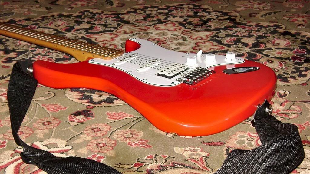

Squier with a stock pickguard:
Same guitar with a MIA pickguard:

actually, the two photos you posted both are 11 hole.

Ah crap. I've done several of these and just grabbed the only before/after photos I had ready.
Still, the factory holes will be covered and drilling will be required. In fact, that's a 1992 Squier and, despite having 11 holes, I still had to drill several (I don't recall where, exactly) since only a few lined up with the MIA guard.
