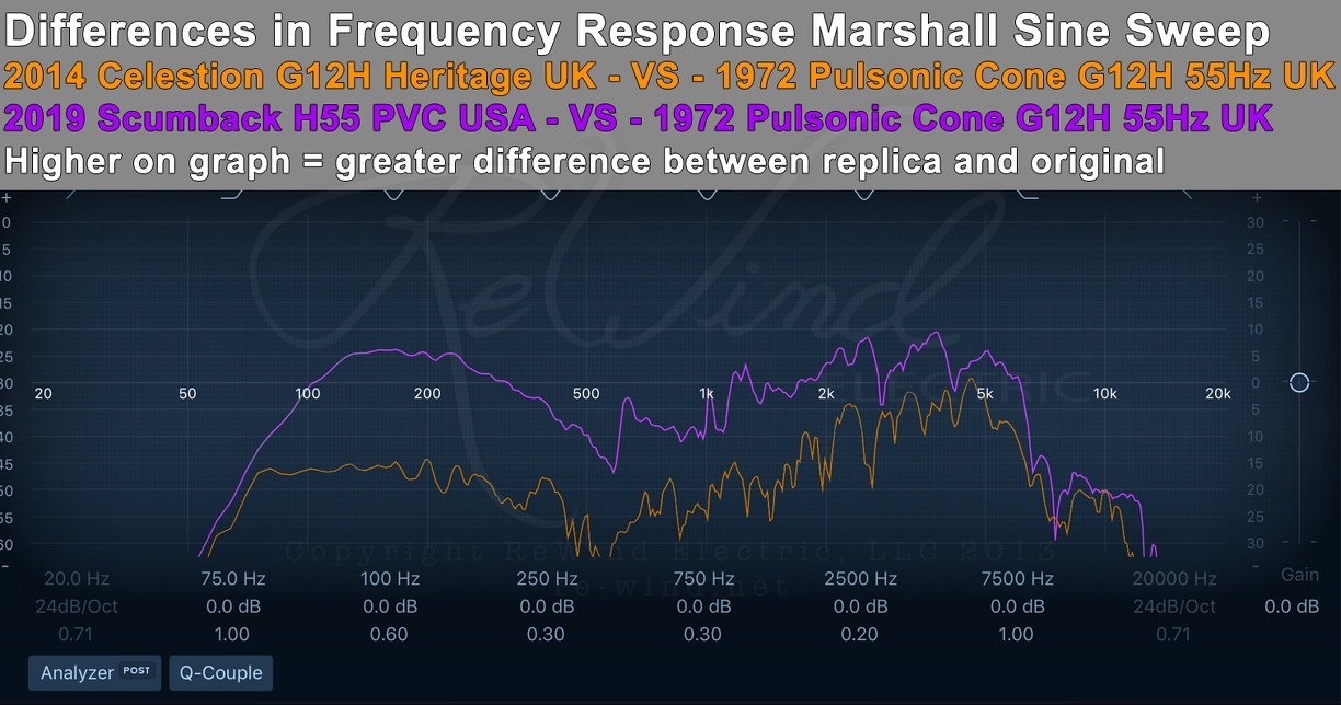

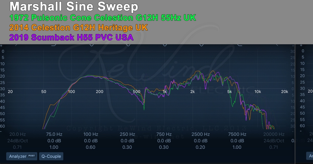

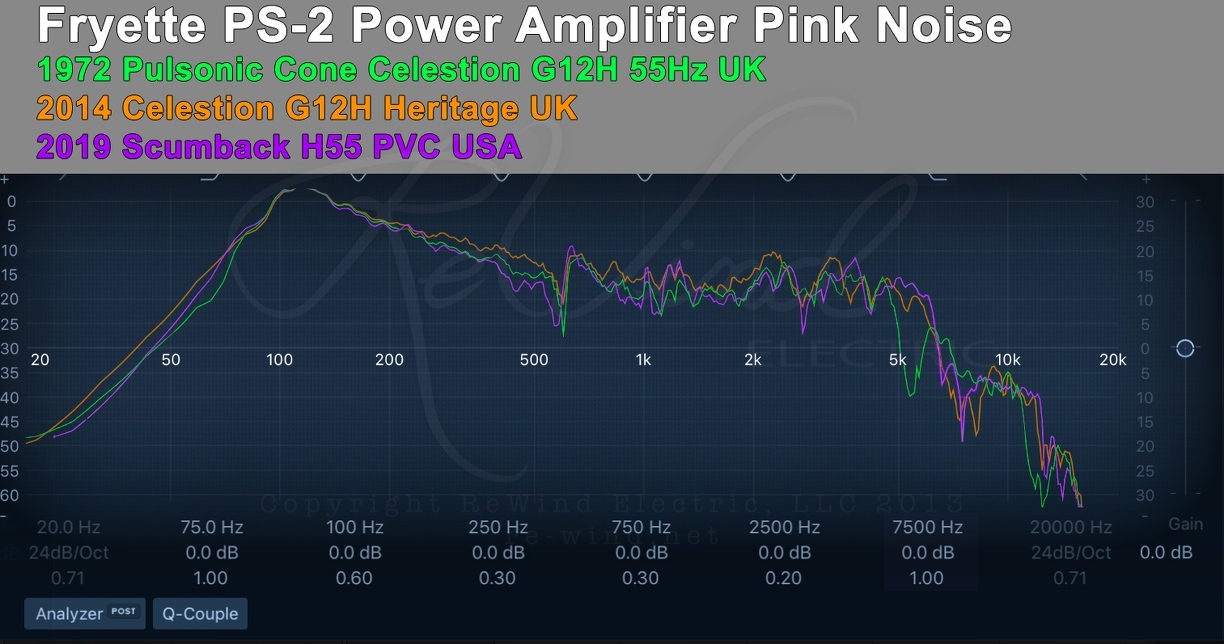

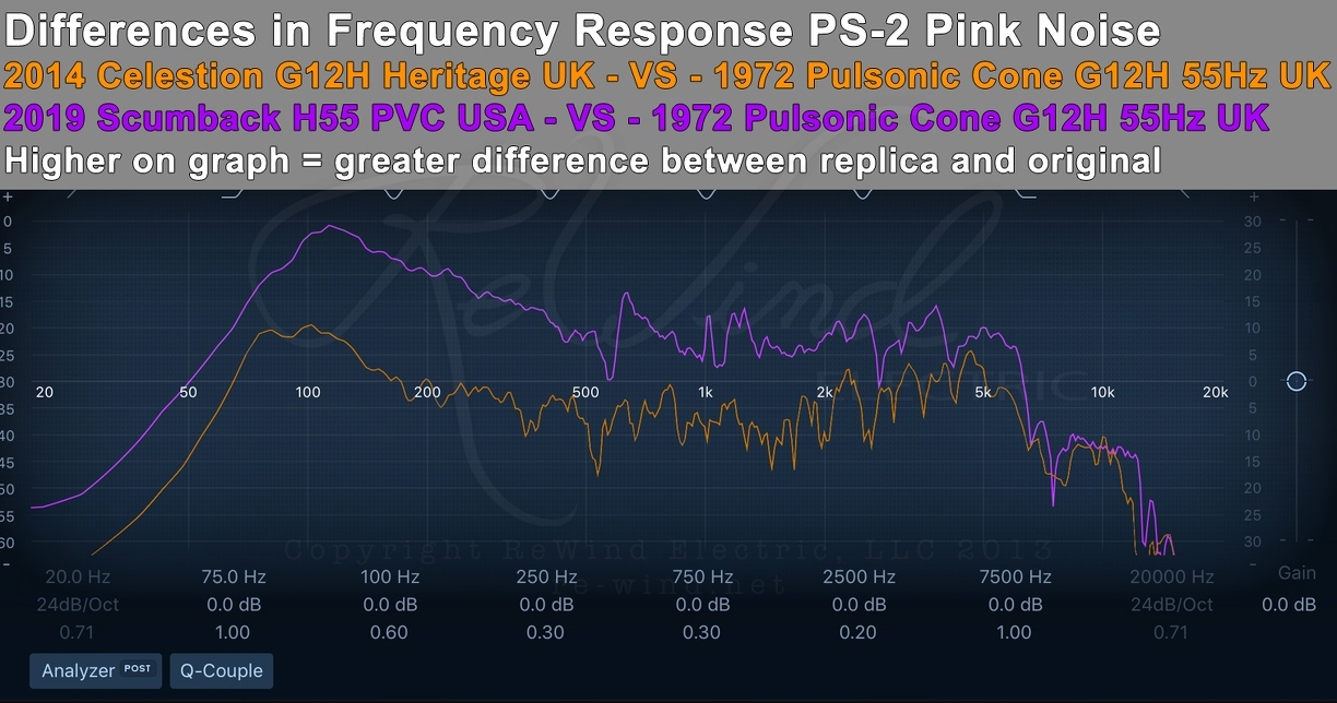

I put together a rather exhaustive comparison of a couple G12H 55Hz speakers, comparing two highly regarded "replicas" to the original Pulsonic cone Celestion version.
The tests are done with a 1959 style Telecaster, an R9 with real 1959 PAFs, and through a SLP and 1960B cab. The test tones portion was also run through a Fryette PS-2 power amp, for a more linear amplifier. Everything is explained pretty well in the intro of the video. There's a guitar audio section with the same take played though all the speakers at once, then separated in software for honest A/B comparisons without human error factor. After the audio, there is a section discussing a series of frequency response graphs made with both amps and two types of test tones.
Here's the spectrometer graphs from the video:

The following graphs show only the difference in frequency response between the modern replicas and original, via inverted phase summing.

So, I didn't want to share my personal opinion in the video but I'll share it here with you guys, now that this has been up a few days and folks had a chance to listen on their own...
I think that neither the Scumback nor the Heritage did a decent job of recreating the sound of the original Pulsonic cone G12H 55Hz speakers, unfortunately.
I find the Scumback to sound thin and weak, way too scooped in the mids, fizzy on top, and also noticeably quieter than the other two. It has a bit more clarity and detail than the Heritage, but not nearly to the extent of the vintage Pulsonic cone speaker. Though a greater amount of detail and note separation is there, compared to the Heritage, it's tinny and brittle sounding compared to the original.
The Heritage has much more midrange and compression than the original. It lacks the clarity and detail of quieter passages and note separation that the other two had. However, I thought it was a very cool modern voicing with nice vocal qualities. I also thought it paired up well with the original in a stereo mix.
Those are my personal opinions based on the sound/feel, not the graphs. I listened on a number of playback systems and rooms including some nice large midfields, some very high end near fields, and several places I'm familiar with and regularly listen to music on. Of course, I also spent plenty of time playing them all in person. I had some colleagues at the recording / broadcast studio I volunteer at lend their ears in a blind test of just the raw audio clips before I made the video and there was full agreement: The Scumback didn't have as much midrange and balls or detail, compared to the original, and the Heritage had way too much midrange and also lacked detail.
It's worth mentioning that I've auditioned a number of greenback "replicas" and, though I think these two fell noticeably short, they are both much closer to the original voicing of a G12H 55Hz Pulsonic cone greenback than many others I've tried. I have yet to try an ASW speaker. I had planned on including one but couldn't get my hands on one. If someone has their take on a G12H 55Hz greenback, and wants to lone it out, I'll run the same tests on it and post an update here.
