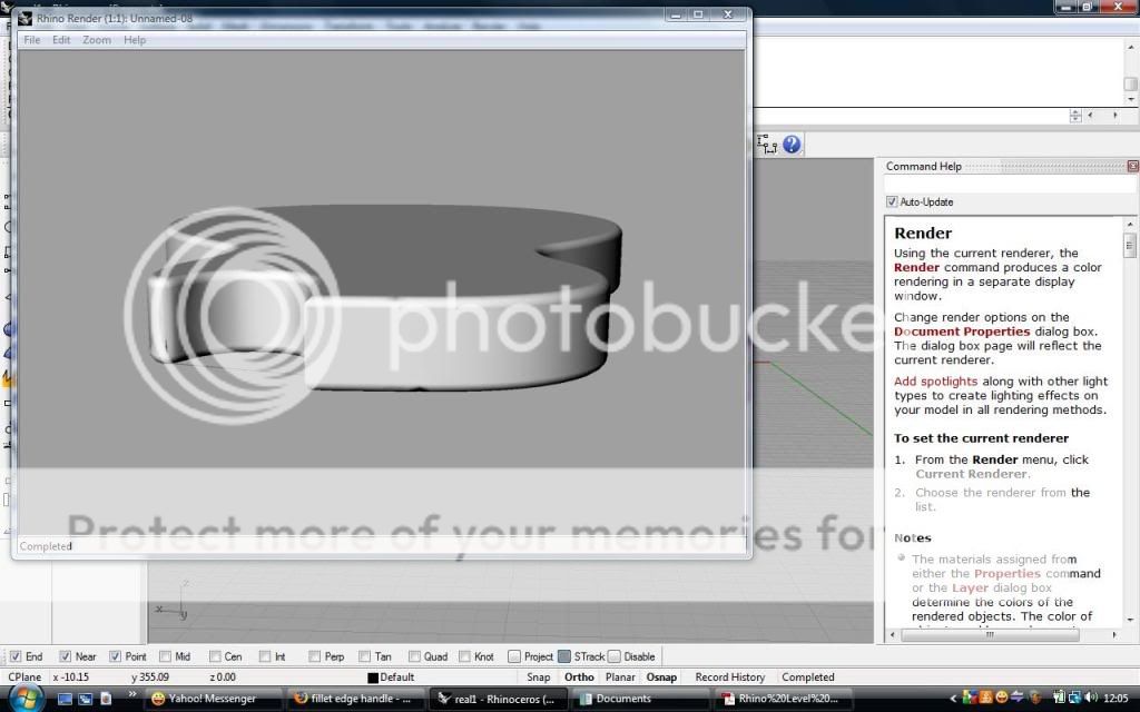

Back to the body,
here I used a 4,7 mm radius around the perimeter that decrease to zero at the neck joint.
I hope it's not to late to ask, but how did you decrease the radius of the fillet at the neck joint?
Thank you very much!
