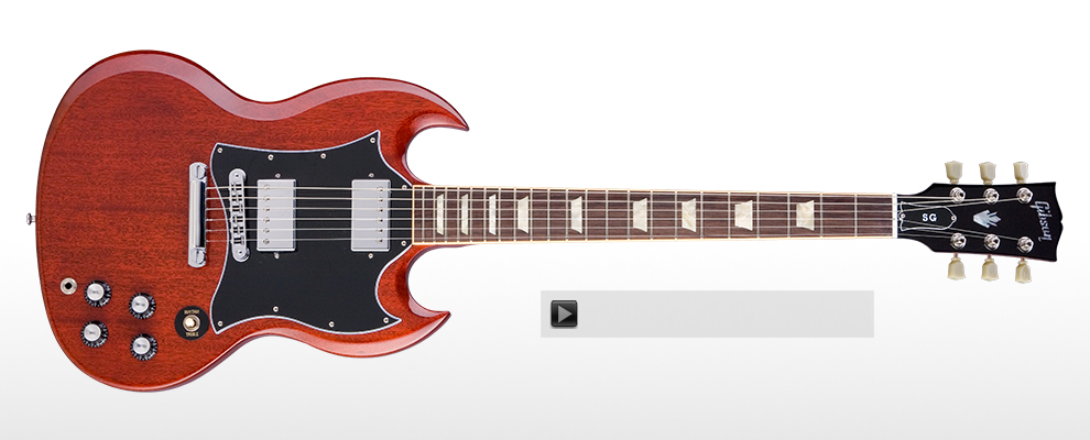

You're right, almost none of the SGs has 24 frets :
USA Standard http://images.gibson.com/Files/128f2ba5-c041-42de-953a-40d84c6de8e4.jpg
USA Reissue '61 http://images.gibson.com/Files/11ddd246-d60d-46ad-834c-ceb0ff8a56ea.jpg
Custom Shop Reissue VOS http://images.gibson.com/Files/7e44f779-c180-40d5-bf88-935c079ed31e.jpg
BUT this one has 24 frets
USA 50th Anniversary Standard http://images.gibson.com.s3.amazona...50th-Anniversary-SG-Standard-24/Splash-02.jpg
Now compare the position of the neck pickup on those 3 with 22 frets and the last one with 24 frets. I guess it's now obvious why LtKojak called any SG a 24 fret-er.
OTOH I ever decide to have a custom built SG inspired guitar made for me - it will have ( among other R8/R9 specs regarding neck shape and thickness) :
- Junior/Special body thickness
- neck moved into the body so the neck pickup stays where it is but positioned on the same position regarding the neck as on the Les Paul (2nd harmonic above screw coil)
- and bridge pickup positioned on the same distance from bridge as on the Les Paul or slightly further from bridge.
