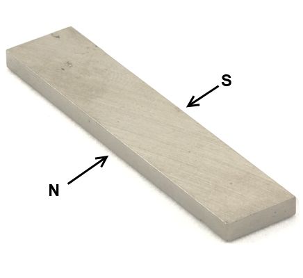

You want to roll it over like a log.
The magnetic poles of the magnet are touching the pole screws and slugs, typically south to screws and north to slugs - along the long edge and through the thickness. So if you just flipped it end over end like a football the polarity is the same.
