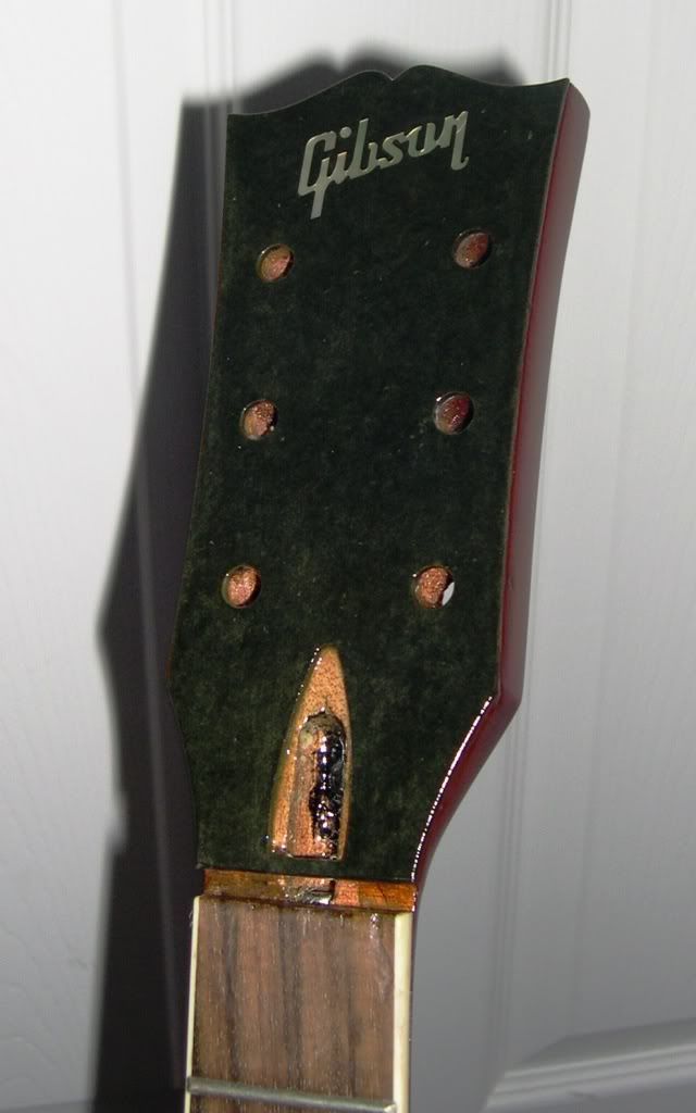

Here are a couple of pictures of the head repair. First is the routing and filler piece to the volute area (dark patches are just unsanded thin patches of mahogany dust filler to shape). I could have got slightly closer to the truss rod with the cutting (angle of picture makes it look out off scale), but just didn't have the balls :D. Still, it's plenty strong enough with all the additional wood.
And this is the first coat of stain (still wet) with circles highlighting the pieces I had to add to get it to shape (you can just see the edge of the new faceplate).

Here is the start of the trouble (when it was unpacked...!!):
When I inspected it properly and had a bit of a "pull/push" of things, this section (in red) snapped off like a dried twig, exposing the truss rod......Great). You can see the quality of the previous owner's shaping (ahem) work on the head too.
Here is the "volute" piece stuck in place and drying, just before I started to shape/sand. The area highlighted in red is the crack (reglued) from the piece that snapped off (above):

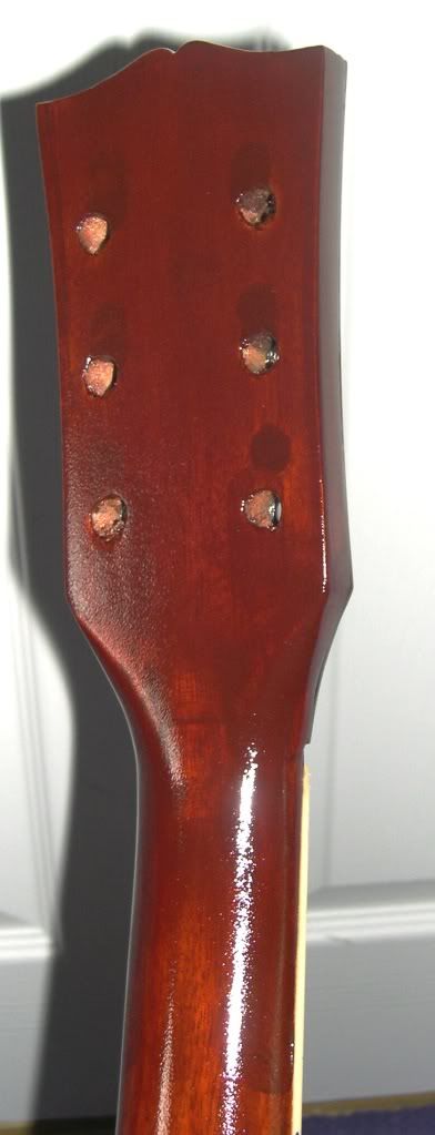

Here is the head with a few coats of clear on it. They need to dry for a week or so, then I can sand, buff and polish (you can clearly see the wet laquer):
And the front (with '59 RI overlay). Obviously had to cut a new nut ledge and am installing a Gibson tusq unit (only 1mm wider overall on string spacing). It's going to be relic'd so I'm not too arsed about a perfect finish. The end of the fretboard will need sorting slightly, but that can be fixed without it being too much of a problem:
