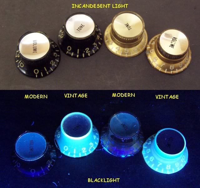

Before painting it, I'd see if there was some CSI trick to finding the serial number.
LOL.... My CSI trick is using a black light. It not only shows previous repairs, but most of the time it will reveal serial numbers that are very hard to read or are nearly gone.
As a part-time luthier I am sometimes commissioned to repair broken headstocks and refinish guitars. I have a set of 6mm and 4mm Gibson letter stamps to redo the serial number and the "Made in the USA" lettering. As a rule I prefer to leave serial numbers alone if they are even remotely distinguishable, but in instances such as this there isn't much of a choice.
Still, if my black light can't give me a definitive answer I'll just leave well enough alone. Even though the original Norlin employee who ran the stamping machine might disagree, serial numbers are a time-honored system of records and there's nothing to be gained by making a mess of them.
I have asked this before (not you), and didn't get a clear answer, so i'll try again:
What sort of UV light do you need, and what exactly does fluoresce on a guitar?
I ask because i have one of those UV LED pens, and that one does excite absolutely nothing on any of my guitars - even the ones with repairs...

Frankly, I just use an inexpensive black light that I purchased at Walmart. It's nothing special, but it works just fine.
My black light lamp cost me about $20 USD and looks something like this...
https://www.walmart.com/ip/Lava-181...fault&beacon_version=1.0.1&findingMethod=p13n
Black lights are normally used to distinguish whether repairs or changes have been made to a guitar. Older parts and finishes will glow while newer items and finishes will not glow. I'm not entirely certain why older things glow, however.

And here is a comparison photo (taken from Google images) of vintage knobs vs recent knobs under a black light.
