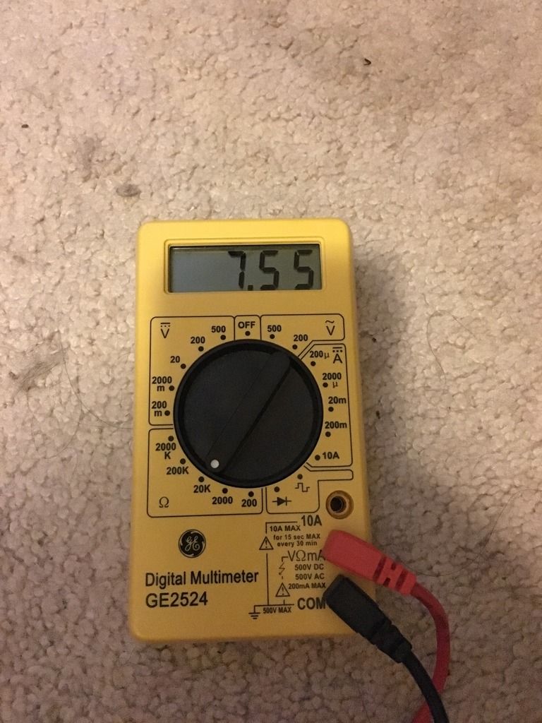

Superpots were a huge improvement. No mud anywhere and the sweep is more usable. They even work with my normal setup, so huge improvement to my ears. I left the tone pots in for now - I plan to re-wire the switch and jack when my wire comes in so I'll change them then.
Pickups at room temp are nearly dead on specs.
Neck:
Bridge:

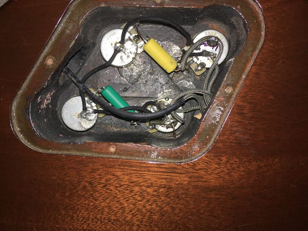

Last post -- I re-wired the guitar and I also replaced the bridge and tailpiece with Faber parts. Here is the re-wired pickup cavity, using all shielded braid wire (the heat shrink tubing is to prevent grounding issues with the hot wire). No change in tone with this but it did get a touch quieter.
The Faber bridge and tailpiece had more of an affect on the tone, and I have to say, they really brought out the best in these pickups. The string-to-string separation is improved, and the pickups are incredibly articulate, but without losing any of the overtones and sparkle that made me love them to begin with.
As I said in another thread, my take on these pickups is they will improve anyone's guitar who wants traditional, vintage tone, but they also will reveal warts in your setup. Since getting them, I've changed the pots and the bridge and tailpiece and each of those moves made a significant difference (improvement) in the tone, which was already really good to begin with. The Dr. Vintage will give you what the guitar is willing to give you, so a better fundamental tone will get you better tone coming through the speakers.

Got 'em!
They read a touch hot out of the box but I'm assuming that's because they had been out in the hot sun all day.
So bridge 8.46 k/ohm, neck 7.94 k/ohm. In the thread where Mr. Satchmo first got them, he indicated they were 8.05 and 7.7, respectively. I assume when they get acclimated to the house they'll drop, but I didn't want to wait around and see so I soldered them in.
