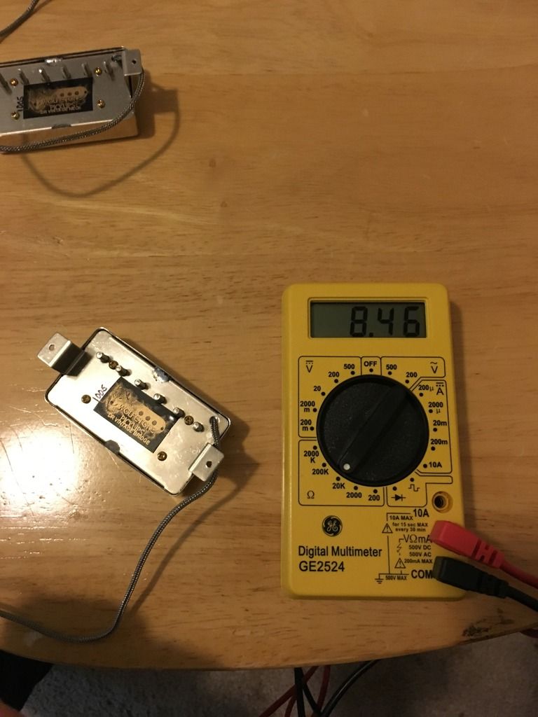

Got 'em!
They read a touch hot out of the box but I'm assuming that's because they had been out in the hot sun all day.
So bridge 8.46 k/ohm, neck 7.94 k/ohm. In the thread where Mr. Satchmo first got them, he indicated they were 8.05 and 7.7, respectively. I assume when they get acclimated to the house they'll drop, but I didn't want to wait around and see so I soldered them in.

Yes, ambient room temp will affect the readings. About about 65 degrees, they should read 8.05 and 7.55k, give or take a tiny bit. 10 degrees difference can alter the reading by about .2k Turn counts of wire are most important, though. Duncan's tolerances are +/- 5%.
Wolfe, I'll certainly do that if I can work in the time.
I re-checked them this evening installed, and they measured 8.03 bridge and 7.54 neck, which probably means they're right at the 8.2/7.7 range. I'm assuming this is one of the neck pickups wound for brighter guitars you mention on the website. In any event, they sound fantastic. I'll see if I can work in time to record them later this week.

Heh. Nope, they're all wound to the same specs. Same number of turns, same wind pattern, and as close as possible to the same ohm-per-foot wire.
Assuming evening temperature was about 65, they're about as dead on as you can get. -.02k on that bridge is about ten turns of wire. lol. 7.55k is the official neck spec.
