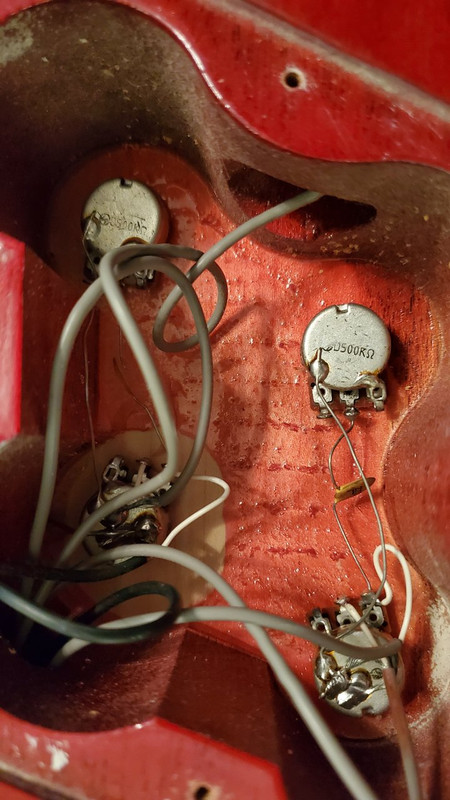

It has a long tenon, 2 hole truss cover, VH-1s (presumably from the last run), small yellow ceramic capacitors, no serial on the headstock or anything marked in either pickup cavity (which would indicate '92, right?), veneered top.
No pictures of the control cavity in the reverb gallery, but I snapped one yesterday - don't know if there's enough identifying info with these pots or not:
Any thoughts or help you all have would be greatly appreciated! Thanks!

Those look like mini pots? When you replace the harness I'd remove them as well and use some full size 500k pots.
I'm uncertain on the year as I haven't seen one with those pots. @o0mobius0o has had a lot of Burnys; a lot more than I have.

Haven't seen those pots either, though they might be okay. Size doesn't really matter. Nothing to nail down a year, but it's Fujigen made so late 90s, early 2000s.

Thanks y'all. Yeah they're really small, wasn't planning on replacing them if they're not garbage, just wasn't sure. On the one hand it's not tonally deficient so I'm not looking to rip everything out and get new knobs and all that if I don't have to, but on the other hand, I can't just... not tinker with it, sooooooo I've got to mess with it some.
Went ahead and pulled the old caps, put an old Gudeman PIO measuring at .015uf in the neck and a pair of old bakelite-encased General Instruments (PIO?) wired in parallel at .016uf on the bridge, and went and moved things over for 50s wiring. Not sure I love that value on the bridge, but the neck sounds mighty good to me. First time with 50s wiring and man it's nice having usable tone and volume knobs.
Also upon closer inspection, that nut might be bone already. Still probably going to have a "fun with magnets" day, at least on the bridge.

There are pots that wouldn't require you to change the knobs. CTS makes a metric pot and Philadelphia Luthier carries those. Alpha pots would also be a direct fit. Bourns use a course shaft knob so you wouldn't have to change those, but you would still have to enlarge the holes in the body to use them. They have a stiffer friction point that I like though as they don't move easily if you brush them. Some don't like that though and others like it better.
