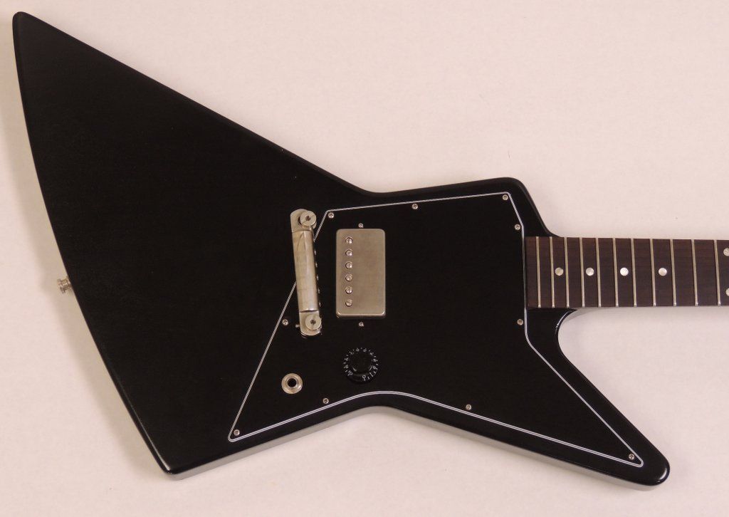

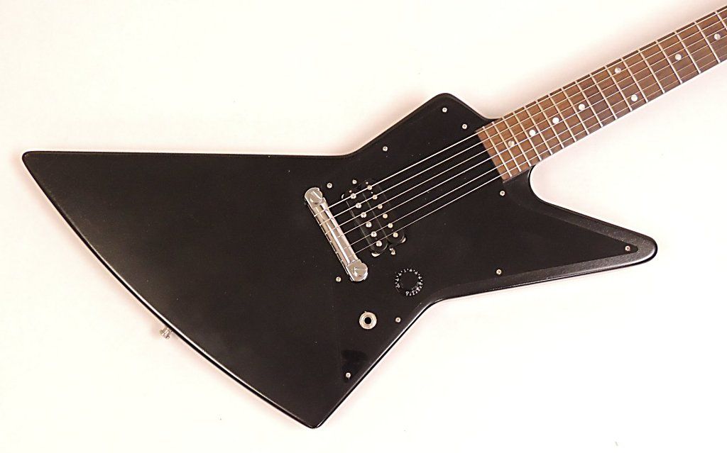

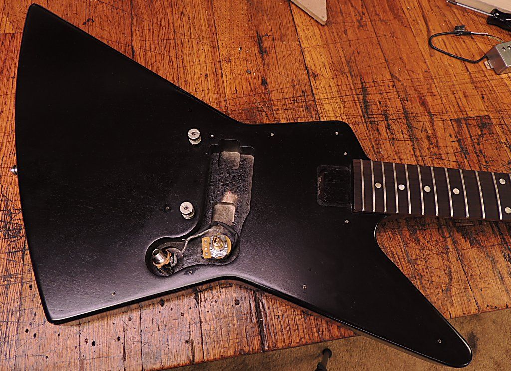

I received the guitar in stock condition which is a pretty basic feature-wise. It features a wraparound bridge, a Gibson humbucker of some sort, a volume control (no tone) and an output jack, all of which are mounted to the pickguard. The plastic is all 1-ply and pretty bland looking. The good news is aside from its boring appearance, its a really nice playing guitar.
This guitar is just begging to be modded, and considering the price paid I figured its a no-brainer. Before I even received the guitar, my thoughts were to add a neck pickup. Once I had it in hand and took a look at the neck joint beneath the pickguard, I decided not to compromise its structure by routing it for the neck pickup.

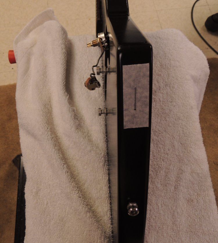

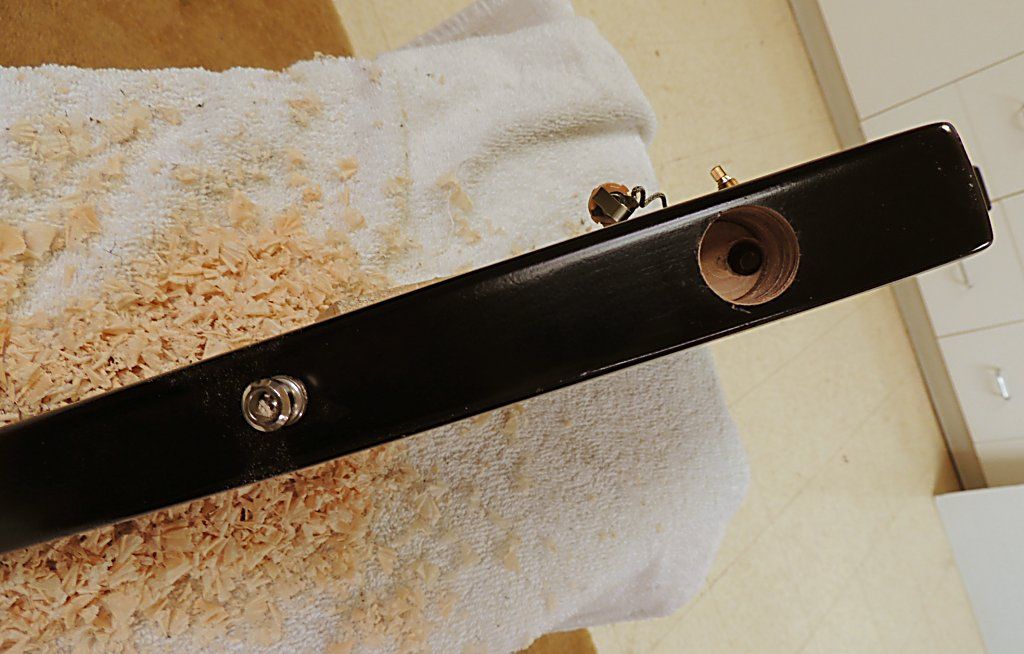

Another mod I had in mind was to move the output jack to the side of the body and add a tone control to the pickguard. I clamped the body into my WorkMate and bored a hole for the jack. The body is too thin for a standard jack plate, so I had to make a rectangular plate.

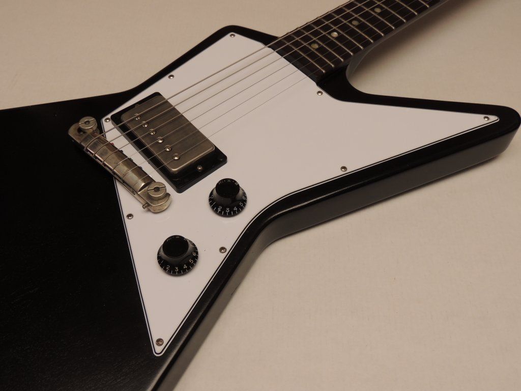

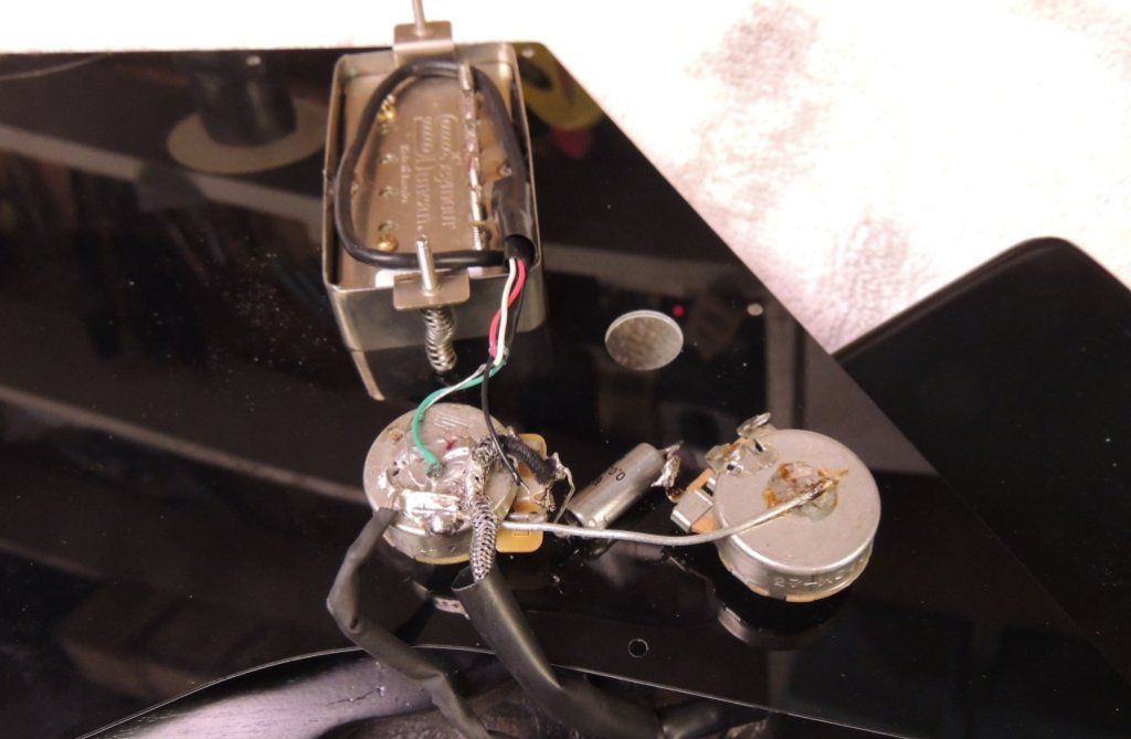

Tone control and PIO cap added, and I replaced the stock pickup with a Duncan JB that was sitting in the parts drawer:

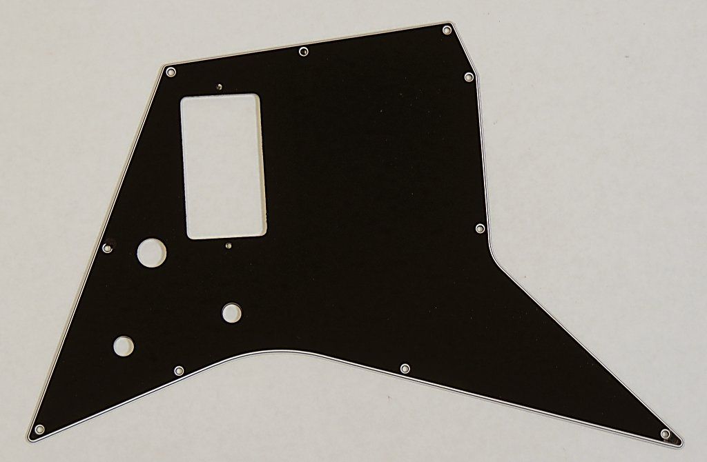

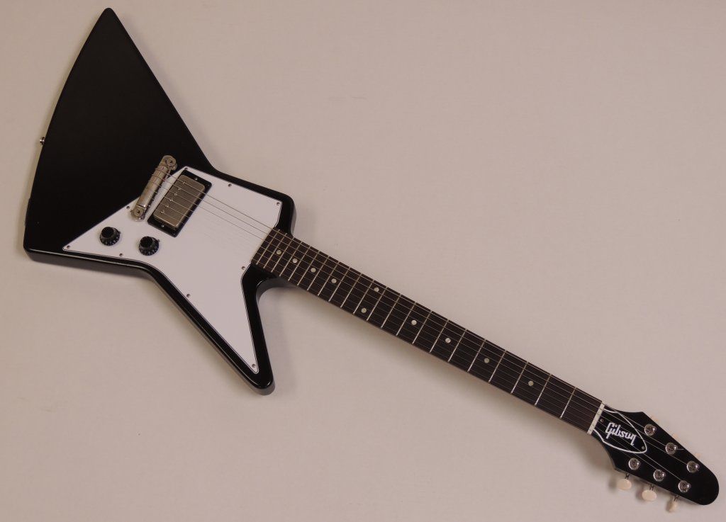

The stock 1-ply pickguard disappears into the body, so I made a 5-ply guard to make it stand out a bit more. I thought about changing the guards's profile, but that would mean filling holes and painting which I don't have time for right now so I kept the same profile. One thing that I don't like about this pickguard profile is that it goes under the bridge, so you have to remove the strings and bridge in order to tinker with the electronics.
After looking at the BWBWB guard, I thought a white guard might look better so I made a 4-ply WBWB guard. I first assembled the guitar with just the pickup mounted to the guard as it came from the factory, but that looked a little unfinished so I added a pickup ring.

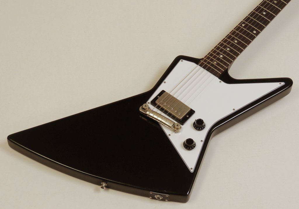

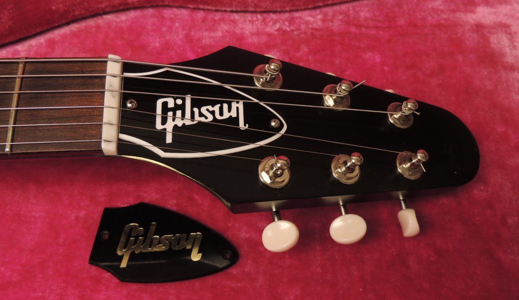

I installed an aged cover onto the JB and added a MojoAxe compensated wraparound along with a pair of locking studs

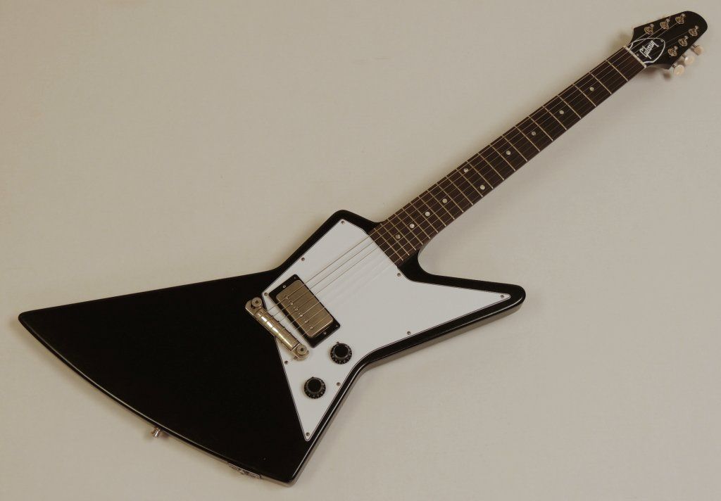

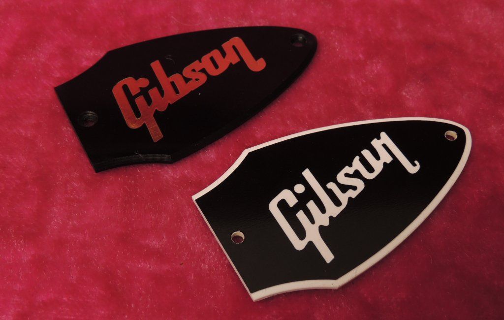

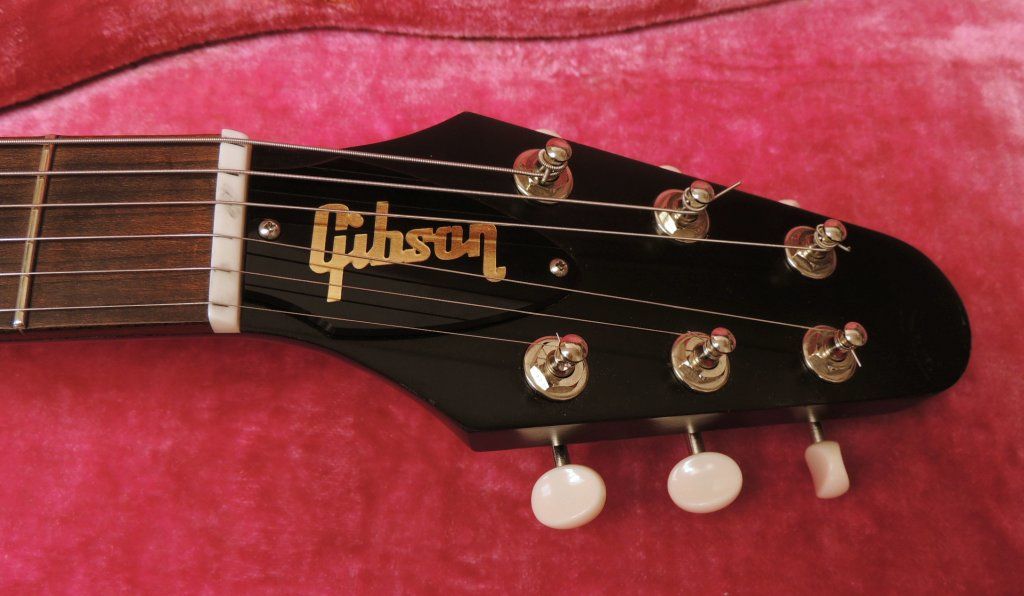

The last bit of cheapness remaining was the 1-ply truss rod cover with gold-leaf printing. I created the CAD data for the cover as well as the Gibson logo and machined a lapel-type cover from 2-ply laminate, which puts the finishing touch on the guitar
The best cheap guitar I've ever owned....
