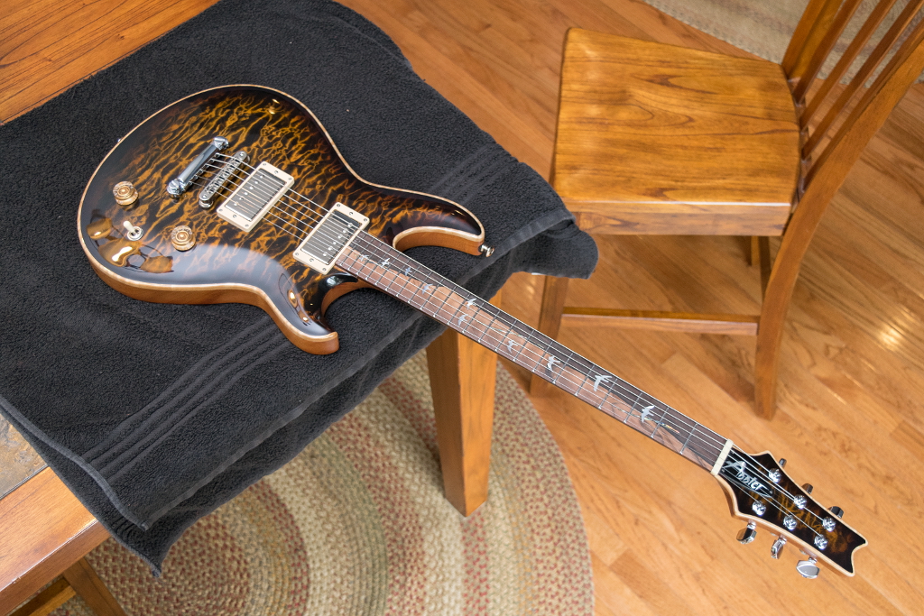

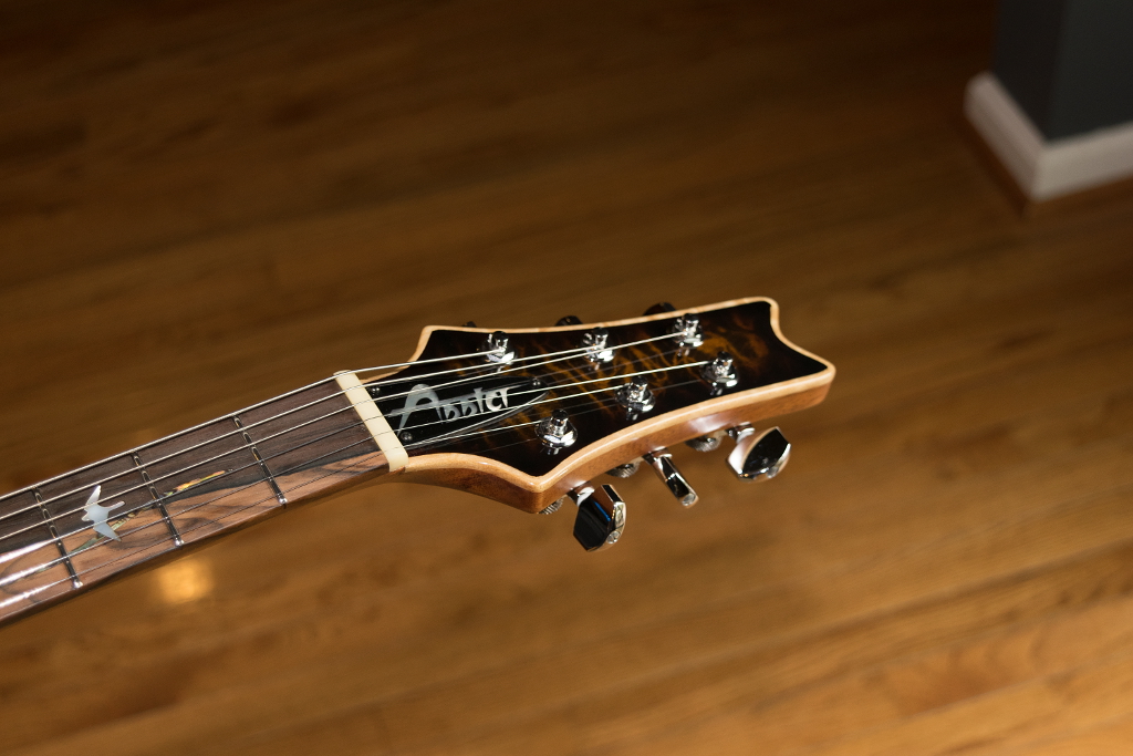

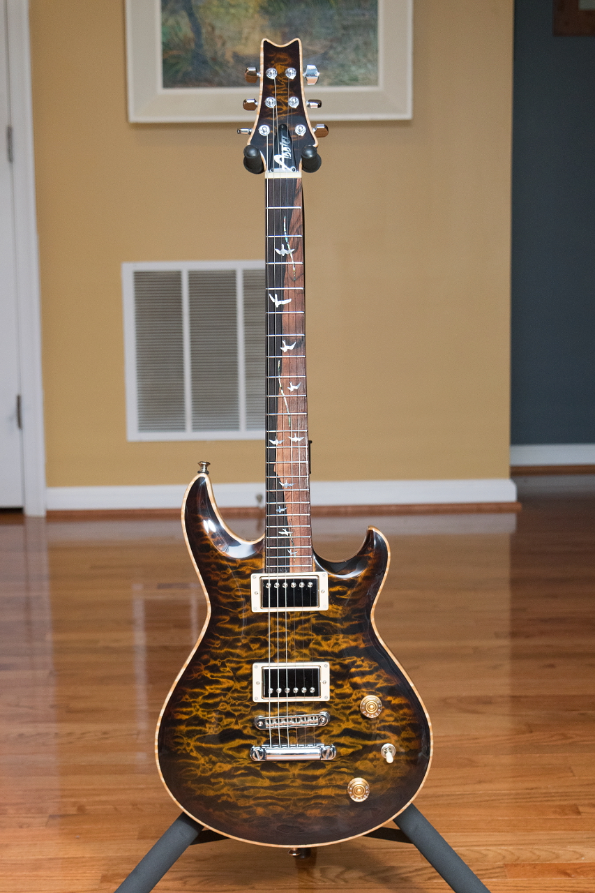

Just stunning Chris! It's incredible that a man can just teach himself to make an instrument that rivals or exceeds the quality of one coming from the most high end manufacturers. This really gives me something to aspire to. Are we going to get any vid clips so we can hear how your grand creation sounds?
Tonyd145
Aug 17, 2012
261
244
Chris, You really nailed the finish on this one, easily rivals PRS for shear beauty. The whole build is awesome. Thanks for sharing your talent here.
