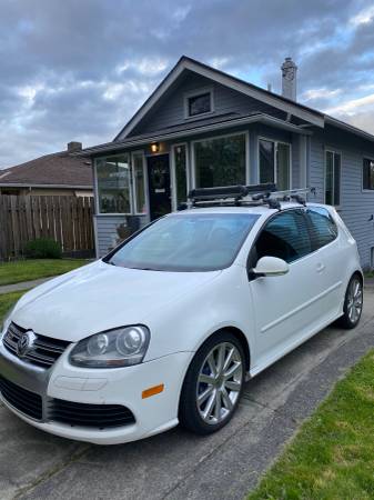

it is a vw. it's an r32. all wheel drive v6. I almost went with a civic but wanted something awd.
