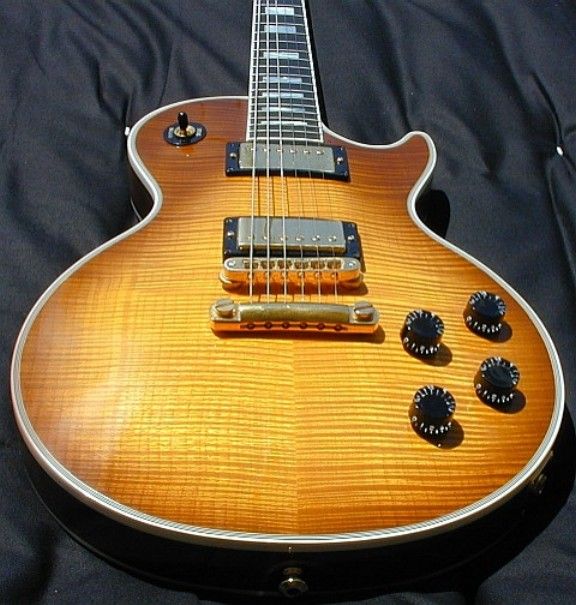

Since there is no clear definition of a chevron’s direction, as it pertains to Les Paul’s, I am going to create my own little kingdom and make a declaration as if I were the exalted ruler of this fictitional land. I do hereby declare that this is Chevron:
….and this is reverse Chevron:
This is Gullwing (Hot Lanta):
This is an example of Horizontal:

great post and idea, though i disagree a little bit with ribbon and tiger stripe examples

Nice post. Very informative. I think it is also worthy mentioning the type of cut used in the top...i.e.: quarter sawn, flat sawn, rift sawn, etc. as each one will display the figure differently. The first example shown (chevron) is clearly quarter sawn which can be determined by the parallel gain lines running perpendicular to the figure. The other examples are hard to tell.

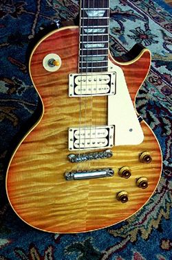

What would you guys call this one?
I've always though of it as a ribbon curl, but not sure.
It's a 2001 LP Standard Plus Honeyburst
