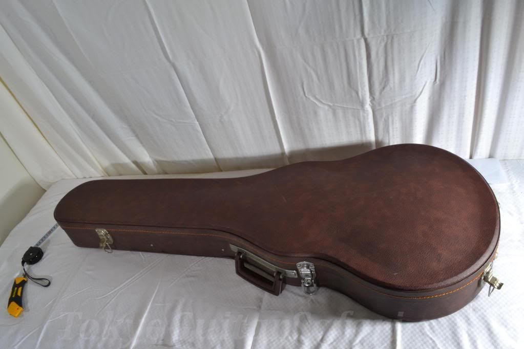

The case.

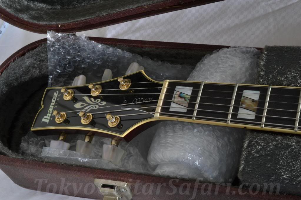

A little extra headstock support. Almost certainly not needed but we do it anyway. Oh, I forgot to snap a pic
of the body but if I had, you would see a small bit of bubble wrap to keep the guitar from sliding around at all in the case.

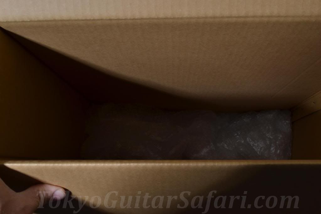

The pad. This about an 8x4ft piece, folded twice then over and over so it is about 24 layers thick. This is pushed to the bottom of the box.
Pushed to the bottom.

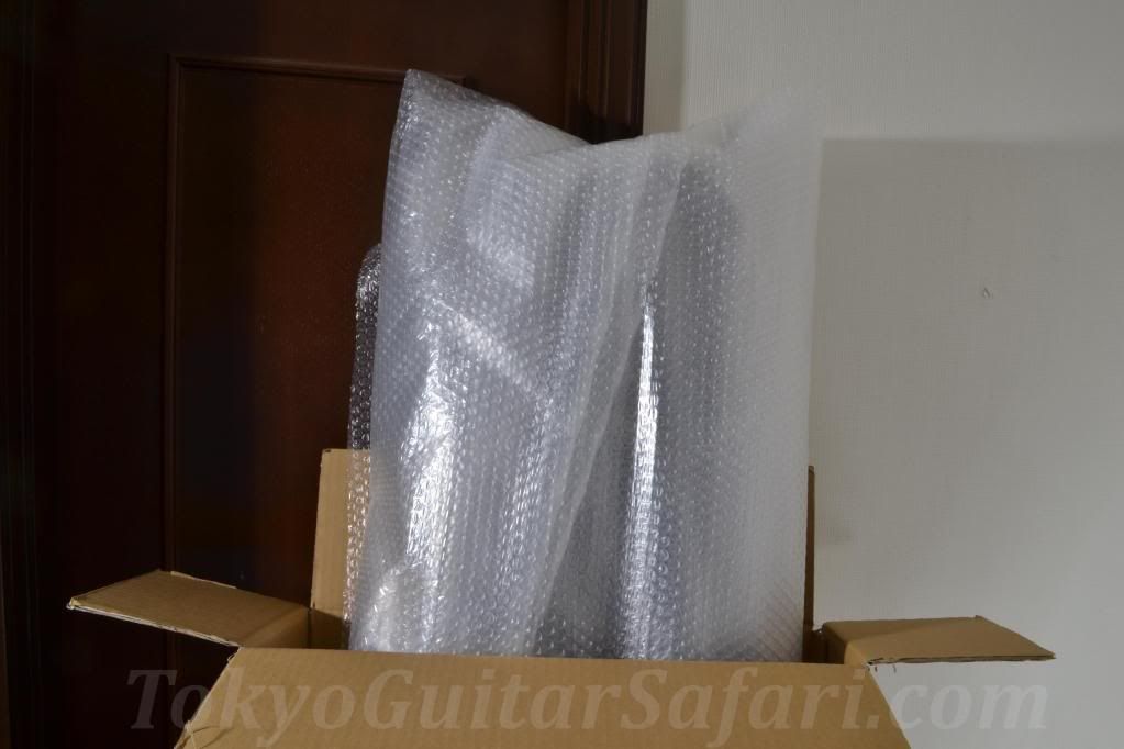

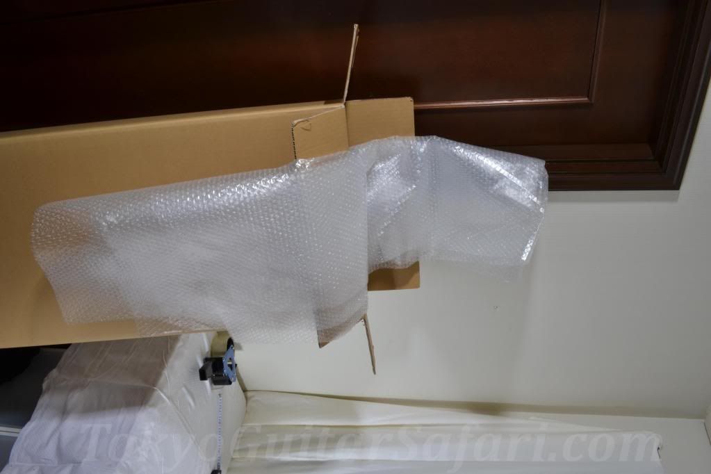

Lillypad. Another 8ft piece folded twice. This will sit on the top of the empty box and the guitar will be pushed into the box.
guitar going in
In some more. Notice the lilly pad filling in the extra space, thus keeping the case
snug in the middle.
Almost there
In all the way. Padding added on either side to keep the case squarely in the center.

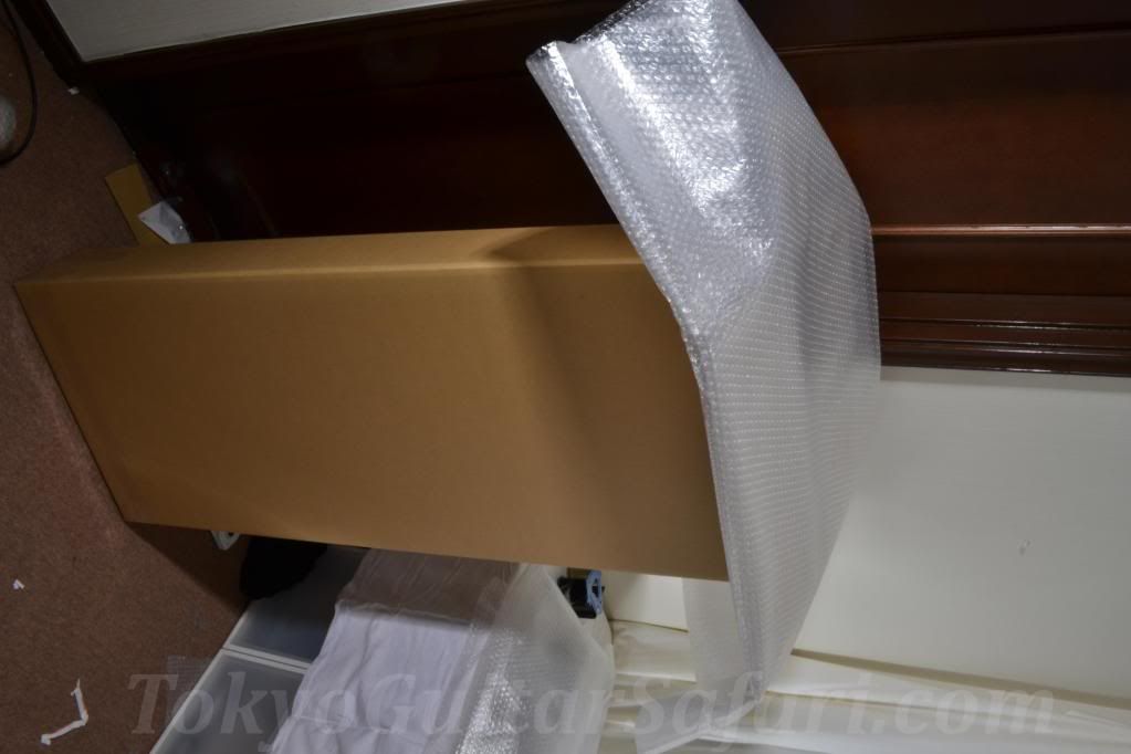

This is another 8x4ft lillypad. It is modified to hang down the front and back of the case. No need to cushion the sides any more at this point.
Long lillypad pushed down along the sides. Notice the box beginning to bend out at the center. This is what we want.

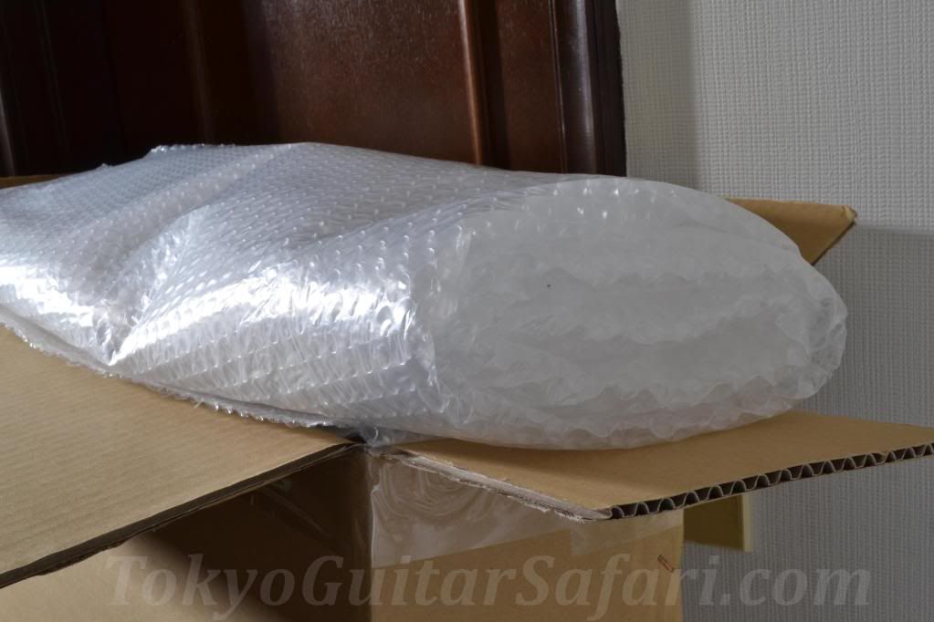

Finally an 8x4ft pad.
Pad in place and doubled up. At least 30 layers of bubble wrap here on the top. Notice the center of the box is bulging out now.

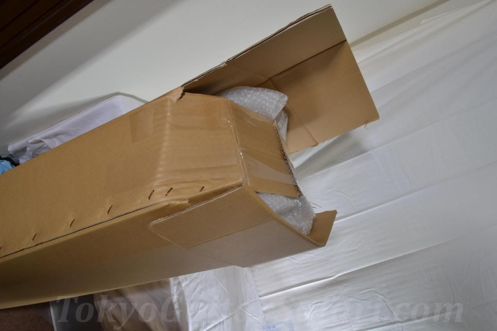

Sides slit down a bit to form the "petals" of the "flower head". Petals are taped down changing the shape and integrity of the top of the box. No chance of whiplash break.
Seen from the top.Imagine that tiny little headstock encased in all that protective goodness!!

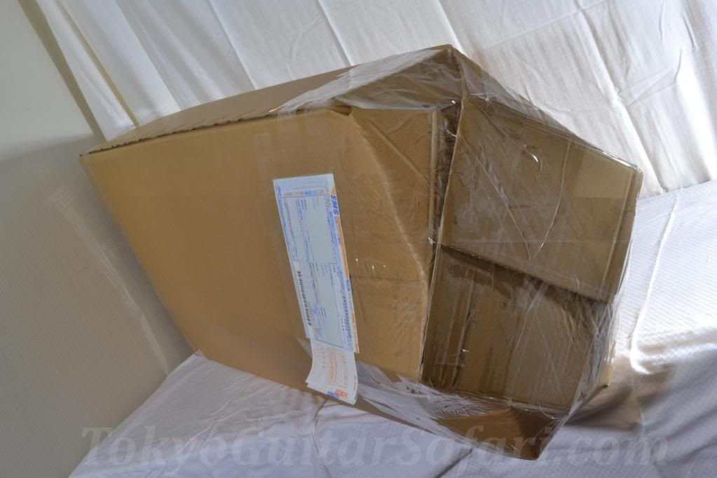

Complete. Notice the EMS label is affixed and then taped on for good measure.
For the record this weighed 9.3 kilos when finished though I forgot to weigh the case/guitar beforehand so take that for what it is worth.
Also,this is not a one off for show. This is how we ALWAYS do it.

The case.
guitar going in
snug in the middle.
Almost there
