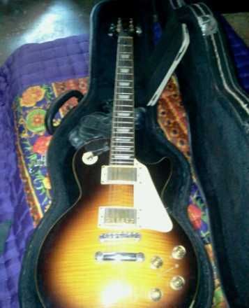

hello guys, need a little help here.
someone offered me a Epiphone Les Paul Classic, it came in Tobbaco Sunburst color.
according to the serial it's made by Qing-Dao in 2004.
I usually don't look the Chinese Epiphone to avoid counterfeit.
but this time the offer was quite interesting.
and I want to make sure that the guitar is genuine.
so my first question, did the Classic ever came from China factory?
well I know that the Classic were produced until 2005-2006 which I read from the Epiphone-wiki. but the wiki didn't mention where did it come from.
so did the Classic all came from Korean factory, or the Chinese had some time producing the Classic?
and upon my inspection, I found that the bridge had B-2 stamped on the bottom, while the stoptail had nothing on the bottom.
Les Paul Classic on the truss rod cover. Grover tuner with 18-1 stamped.
did the genuine Classic had those feature?
well, my 1996 Korean came with different parts. tulip style tuner, Jin-Ah bridge, Gibson on the truss rod cover, long neck tenon, straight Epiphone logo. well typical 95-96 Samick made Les Paul.
the pickup already changed to SH-55 pair. the pots also changed to CTS. while the switch had Epiphone marking. the knob seems also has been changed, it had gold speed knob. and it had pickguard.
the serial EE040711xx, written in black color, and I need a proper lightning in order to see it (well my ex-1996 Standard also had 'difficult-to-see' serial because of black color). the EE font looks okay, seems unity with the numeric serial, not separate or overriding the numeric.
well, I know that the easiest way to verify is from the picture. but unfortunately, I forgot to bring my camera when I'm inspecting the guitar.
and these pictures was sent from the seller:
well, I'm not sure the pictures will help.
but anyway, thank you for any comment or info.

Nothing wrong with that one
I have two Classic Gold Tops - a 2003 from Korea:
and a 2005 from China, which has been treated to some Bonamassa styling:
I like them equally!
So, if you like the look and feel of the one you've found and the price is right, get it on!

As Pete highlighted, the Serial Number being written in black is odd... I've never seen it like that. It's either in gold or stamped into the wood usually

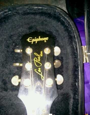

something raised my attention.
did later Classic came with this kind of truss rod cover?
well, my older Korean 1996 Classic have similar truss rod cover, but with Gibson on it, just like typical truss rod cover from 90s Korean Epiphone Les Paul.
and pictures of more recent Classic I found on the net, have different kind of shape. like a more recent truss rod cover used on other Epiphone Les Paul but with Les Paul Classic written on it.

Interestingly slim, that appears to be a hybrid of the two TRCs on the ones I posted!
2003 - Gibson labeled (which is commensurate with the earlier Korean ones) and has the same shape as the one you posted:
Whereas the 2005 has the same lettering, but different shape
None of that is conclusive either way of course and I notice that the 2003 - 2005 Les Paul 'Classic Plus' on the Epiphone Wiki has a TRC shaped like the one in your picture
The photo of the Serial number you've posted isn't helping much either... I wonder if the Serial had been 'rubbed out' and perhaps you're seeing the remains of where it used to be in the finish..? Of course, that in turn raises a question as to why that might have happened...

Control cavity would also help, as would the pickup cavities... but there's really nothing that raises any cause for alarm other than the odd serial number

Nice looking burst, upgraded PU's & pots, sweet! I play an '05 Korean Classic and have come to like the model. In the pic you posted, I agree with Clive, it looks like someone has tried to rub the SN off. In my experience, SN's that have XXX are indicitive of a factory promo, Grade B stock, or a repaired instrument. All that matters is that it plays and sounds as good as it looks!

The trussrodcover looks ok to me,
the serialnumber should have been in gold letters
it could have gotten a refinishing
all in all the guitar looks fine to me

It's in need of plenty TLC and I'd personally be absolutely gutting the thing, starting again with the electrics, replacing hardware and giving the fretboard and body a full workover, but other than that, looks good
Complete with authentic gaffer tape mark too!
