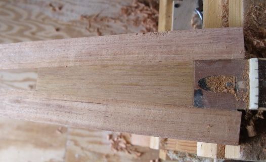

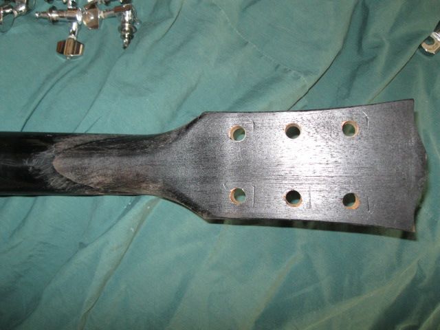

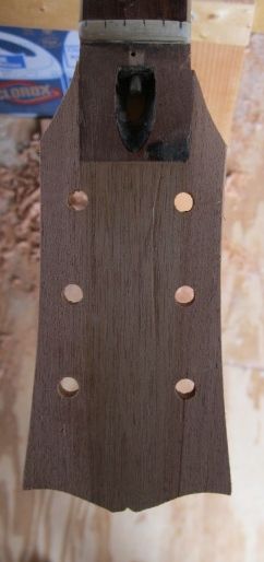

I've made a repair like this before in a couple different ways. First is to scarf a new peghead onto the existing wood with a Luthier joint. Basically a flat is created from the back of the nut going towards the heel. A new peghead is created with a matching angle to glue to the flat. That one is tricky because the new wood has 2 acute angles cut from the block as well as fitting around the truss rod and being square. It's a rewarding repair to do though and you can occasionally find Gibsons in that condition that people shy away from.
The second type is to temporarily join the existing peghead back together with glue and rout splines into the wood in both directions from the break replacing the crack with new wood. Obviously you don't want to run into the truss rod in either case.
Then there's the add wood to the center and add ears to that for support :
