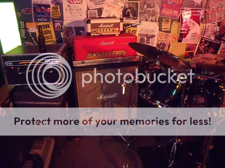

My cover band plays out every weekend, and I use my Heil talk box alot....I use a Marshall Lead 12 head into the talk box. Tube into my vocal mic...old school.....
I have the input of the Marshall Lead 12 connected to an A/B/Y box, so I can choose just 'guitar', just 'talk box', or a combination of both (like on "Man In The Box" or "Walk This WaY"
