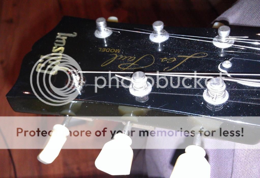

After ten years of solid service I've decided to replace the Gibson deluxe tuners on my 02 Standard. I wanted tuners that were a direct replacement and more importantly i wanted to try locking tuners. I never had any tuning issues with the old ones but the D and G tuners were starting to have a lot of slack in them. I also liked the idea of super quick string changes which would encourage me to change them more frequently and not once in a blue moon when i could be bothered.
After a little research i decided on the Gotoh SD-90 with magnum lock (MG) and tulip keys (SL).

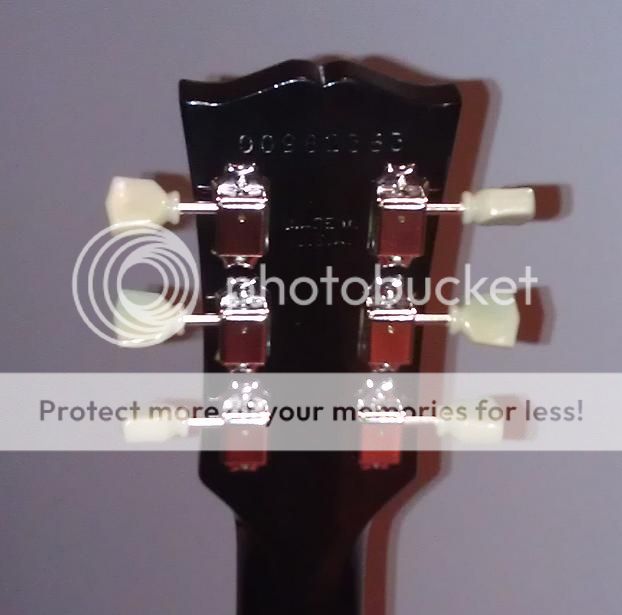

The old tuners
Box arrives in my mail box from OS

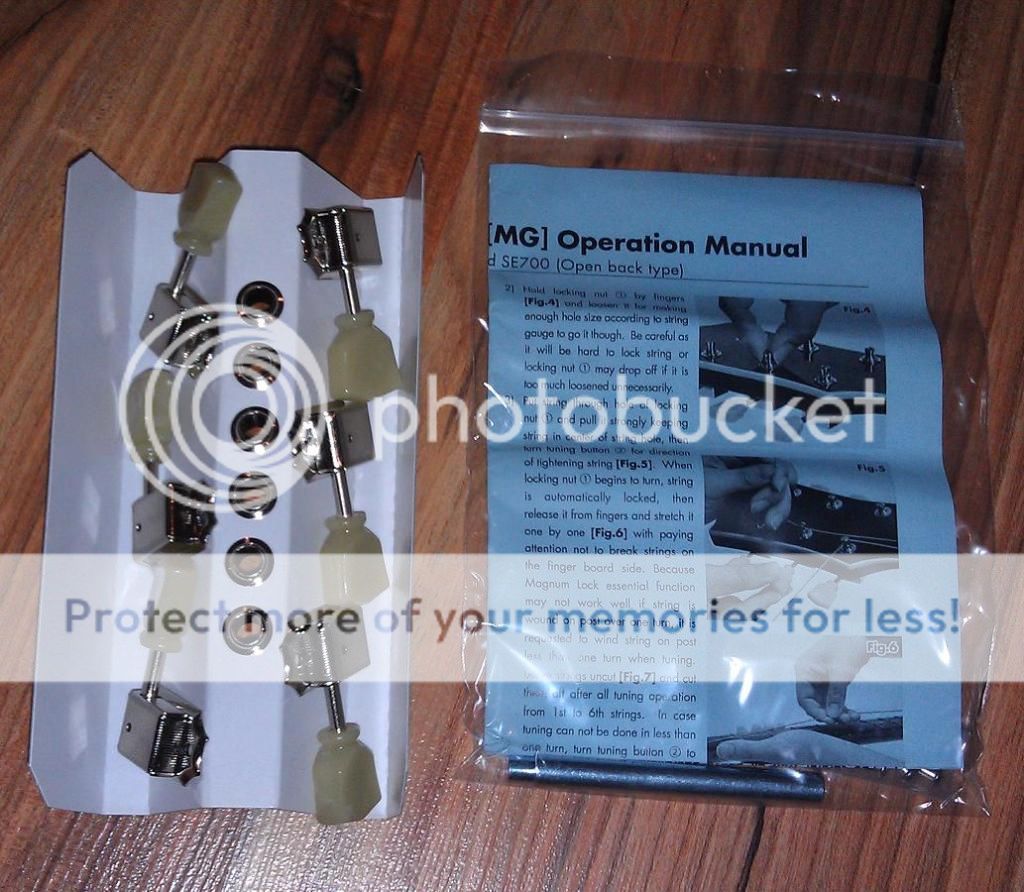

Contents of the Box.
Tuners plus bushings, screws, old bushings removal tool and instructions
The new screws are a little longer than the Gibson ones

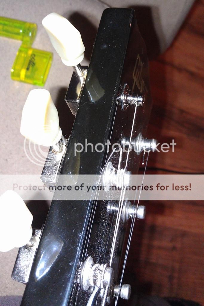

I started by only replacing the D tuner.
Old bushings came out easy with a little encouragement with a rubber mallet and the removal tool.
The gotohs are a perfect replacement for the old deluxe tuners. New bushings went in with only a small amount of tapping, overall snug as a bug and the screw holes are spot on as well. The longer screws went in with no issues.

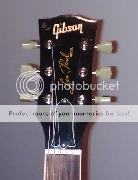

D tuner installed

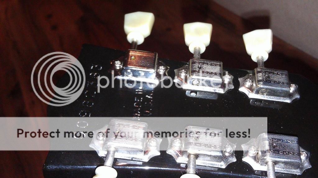

New tuner is top left
Bottom left
All of the others went in just as easy.
Strung up quickly.
The tuners feel really solid and well made. I can't comment on how well they stay in tune until i've done a few rehearsals and a gig or two.
Overall i'm really happy with them and was very glad that they were a drop in replacement.
Aesthetically they look really good. They're a lot shinier than the old but i'm comparing brand new to ten years old. The keys are perfect match for the old ones. The only difference there is that they seem to be a millimeter or two longer in the shaft.
Final pics of the full install

I put the same set on my 96 Classic about 6 months ago. I also wanted direct replacement and a stock look. These fit the bill perfectly and function without any issues. Highly recommend them :thumb:

Trio, I'm sure Leroy will chime in as well but I'm glad to give you some tips. The tuners come with a small aluminum punch to drive the old bushings out and install the new ones. It was a very easy process but then again mine went into a 17 yr old guitar. If your new bushings seem really tight, put them in a freezer for a couple of hours.

What I'm interested in is learning more about a good technique to use to drive the old bushings out by tapping with a hammer/rubber mallet. Like how do you do it safely without causing any damage.
Taking a whack at the headstock has me concerned.

I did the same as Findthetone did. I used the removal tool and a rubber mallet. I gently tapped from the back and they just came out. I had to hit it firmly but nothing to drastic. When replacing them I used the gotoh bushings and the removal tool to hit then in from the front. Don't worry too much, just do it.

I know that when drilling to widen posts holes it's good to tape around the hole to prevent nitro chipping. Try that around that area when you decide to tap them out.
