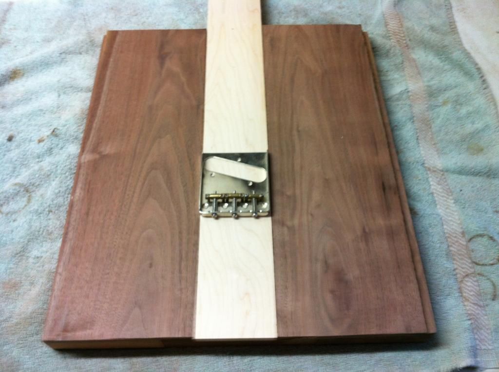

These walnut boards will be the body.
I'm honestly still deciding what it's going to be.
My two leading ideas a sort of Dano Pro-ish bowtie look with a pair of firebird pickups.
Or maybe just a plain old telecaster. I don't own one and they sound pretty cool.
Not sure yet.

Interesting. Definetely make a Telecaster, Danelectros are fugly IMHO!
Post pics when you're done

Super cool project! The world has enough Teles, go wild with the design :)

But the fretboard is looking good! It cupped some on day two but I put it in clamps. Took it out today and planed out the cup and it seems to be drying nicely. At 3/8" thick now, it shouldn't take too long to dry.
And I started working on the top. I figured a nice maple stripe down the top to match the one in the neck would look cool.
