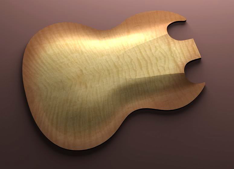

This thread will follow the building of my own custom guitar. An SG body with a 59 Les Paul maple top carve (SGLP).
Here is a computer model to give you the idea:
I made the model so that I can CNC the top. The sharp lines will be sanded out during the build. I started a chambered American Black Walnut version:
