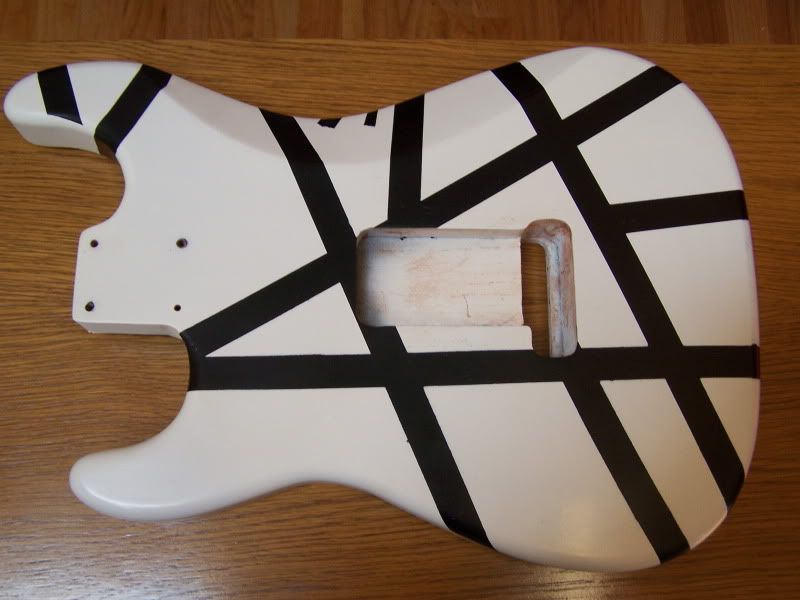

A friend of mine and I are making our own Frankenstrat. But we're making a replica of the red & white striped version, as accurately as we can, down to every scratch nick, smudge and '71 quarter.
We're currently relicing the black & white version of the guitar since he sprayed red over the top of that. We also did not add the narrow black pinstripes because they are not present on the red version. I suspect he used black striping tape for these when they were on the white version.
Anyway, below are photos of ours before we started putting wear on the paint.

you should scrape that black paint off the neck pocket....no good for tone.
