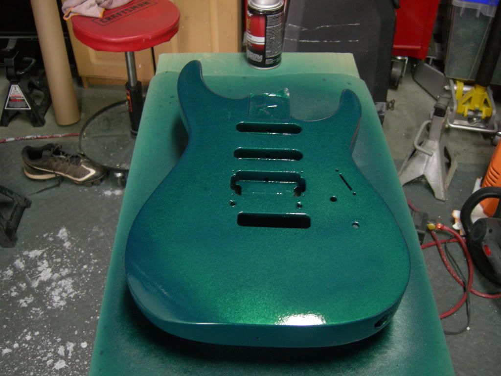

Thanks. Here it is after four coats of clear. Paint and clear was done out of a rattle can. Instructions say to wait 48 hours on the clear so I'll wet sand and rub out on Saturday.
My second time. If I do any more I might just go to Harbor Freight and get a spray gun.. And yes, I sprayed it horizontally. I had bad luck with runs on my first time. I just couldn't get a decent wet coat with it hanging it vertically. Could be a spray can issue.

If you want to save a little hassle, before your last couple coats of nitro sand the entire guitar flat at that point with nothing coarser than 320 (400 would be better). Then blast a GOOD wet coat of nitro on. It'll melt all the sanding marks out and it'll really level out.

Gerry. Looks great. Is it Nitro or Enamel or what? Digging the color.
DougK - Thanks for the tip. I will keep that in mind when I do my next rattlecan nitro job. Until then I continue to muddle along with my Rustoleum JR. Will your sanding trick work with Enamel like I'm using? Definitely going the horizontal Wetcoat route for the remainder of my clear.

looks like a duplicolor car paint can in the pic (acrylic?)
I found duplicolor to be on the thin side, but worked well for me.
Yes, it's Duplicolor for the color coat, but I got the metallic green because they come in larger cans, not the friggin little factory OEM color 8 oz cans. The clear comes in 8oz so I bought two. I was able to do four coats on each side with those little cans. This guitar is going to be flipped anyways. It didn't move on Craigslist with all the paint chips and scratches so I'm hoping that the change from beat up black to new metallic green will get this Jackson sold....and yeah, it was just plain fun to do too.

It probably will be no promises. The big thing about lacquer is its remelt ability. Ofcourse that's also what makes what you put UNDER it so important.
