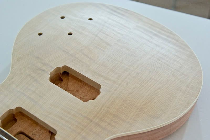

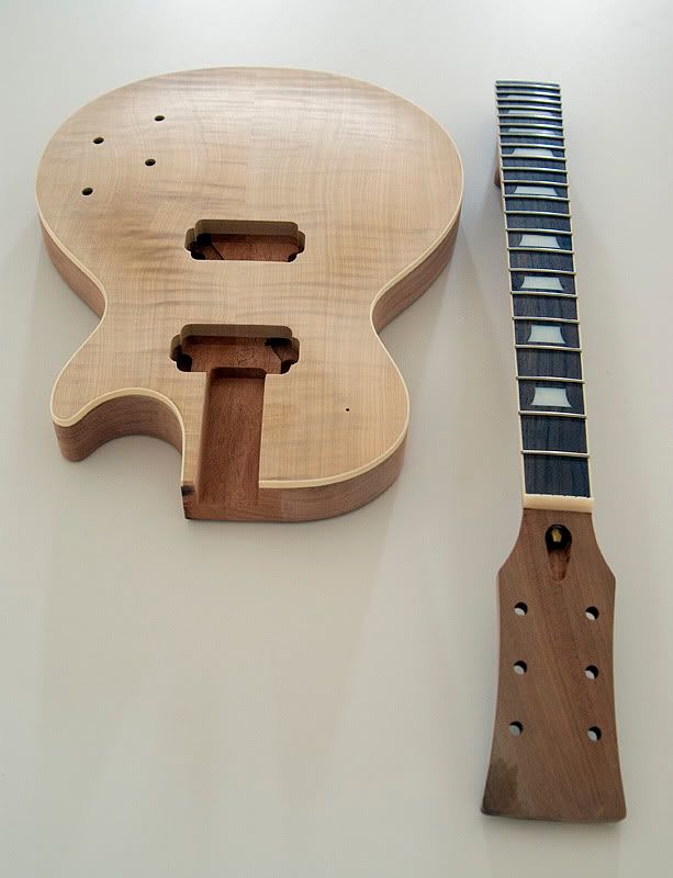

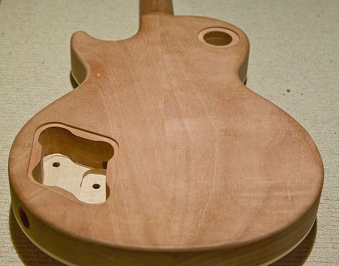

Got my Bulldog kit just before Xmas and this is it when I received it. It's a solid flame top and one piece neck. I'm pretty happy with it, just a few things that could have been better. The top center join is a fraction off center. (See Photos) The neck is straight and not slightly concave when strings are on and in tune. I'm using 9's so I'll have to go with a heavier gauge to give it the relief I need. The flame and grain are quite nice nothing spectacular. The back is two piece.
Here's a few pics....
