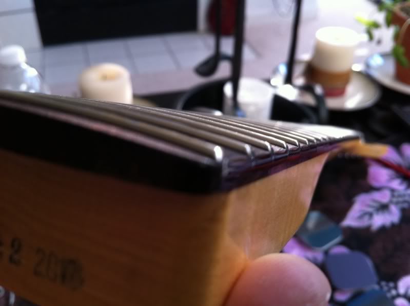

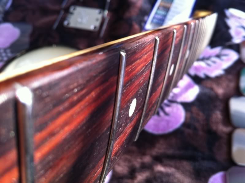

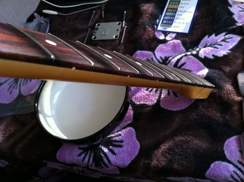

...and I'm glad to say I feel successful.
Fretwork has always been something I've been apprehensive about. I finally bought the tools and grew the balls to have a go at taking care of some exposed fret ends on a Strat.
I used a 6" fret leveling file to knock off the bulk of the exposed ends, then cleaned up each one with about 5 passes on each side of each fret end with a fret end dressing file. Finished up with a series of micro-mesh pads, ending in a wet sanding with 12000 grit. This was perfect for this Strat as the rosewood fretboard is factory buffed and very smooth.
The pictures are pretty awful, but the guitar went from uncomfortable to play to wonderful feeling to me. I couldn't be happier with my first go at some minor fretwork.
Feel free to tell me everything I did wrong though, I'm all about learning. I have a Jazz bass that needs the same work done next.
The camera makes that 22nd fret look like it short or something. That's just the photo. It's fine.
