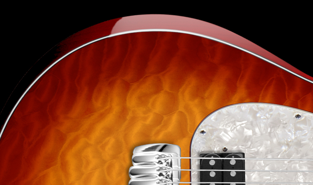

Yes. Inset 1/4". Similar to this pic, only a uniform distance from the edge all the way around. I don't think I would try this without CNC.
The polymer I will be using cures to a cream/ivory color, with options for black or white dyes.
