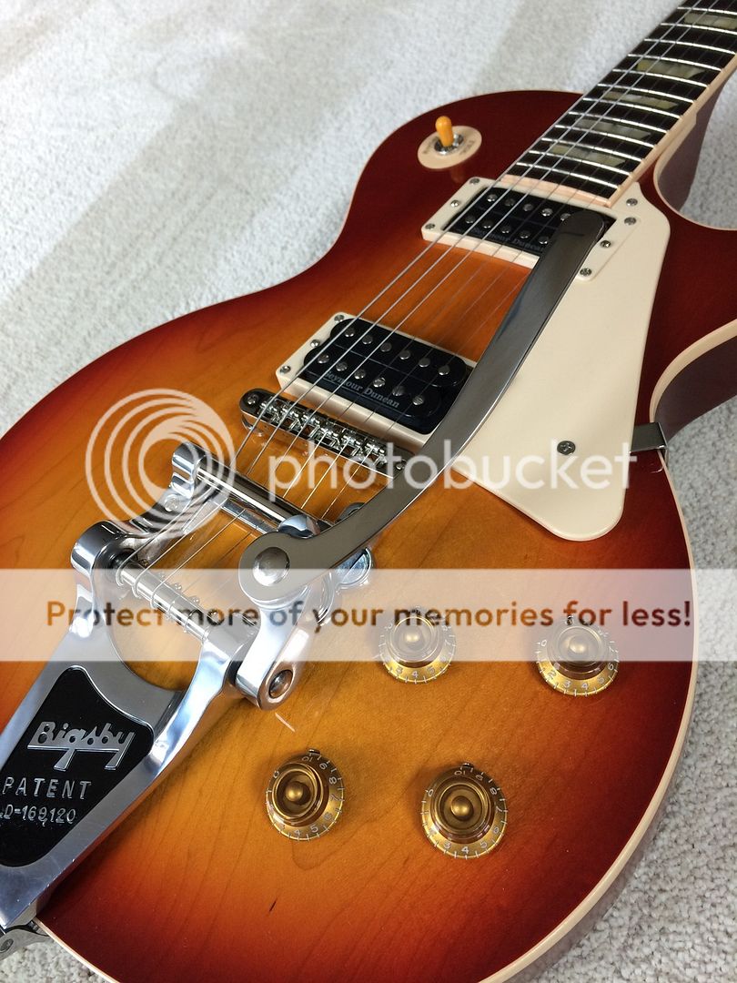

I just got mine back and added a B7 and V7 and tonepro roller bridge recommended by my luthier. She's a traditional pro with locking tuners and Pearly Gates. I have read many posts on many forums. So funny how we all have different experiences. I have to say...I noticed increase sustain without a doubt. Now, it could be the pickups (installed at the same time), the mass, or whatever but I love it.
I went in expecting this to be an experiment and assumed I'd be disappointed because I'm picky, but I love it.

Holy. Necropost Batman. I forgive you because that plain top with Bigsby is hot.
