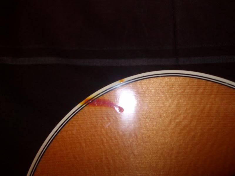

Hey guys, I have a 2003 Gibson J-185 acoustic that suffered a mishap a few years back. It was sitting on a guitar stand in my music room, and a neighbor came over with his kid. While we were talking, the kid wandered over to the guitars, and he had a packet of taco sauce in his hand. He was squeezing it, and it popped and sprayed on the guitar (weird story, I know). He was too scared to tell me about it, so the hot sauce stayed on and burned into the finish. I didn't notice for a whole day, and the crap burned right through the nitro and spread underneath. It burned a little hole in the nitro and spread through onto the maple, and on to the spruce of the top. Horrible story, innit?
Question is, I'd like to refinish this. It really bugs me, people point it out and I'm tired of that. I'll never sell this guitar, so I'm not worried about the resale value/refinish issue. What's the best lacquer to use to touch this up, or am going to have to strip the entire finish and start over? I already know I'll have to sand the offending areas down to the wood and the stain off of both the spruce top and maple sides. My question is, what's the best lacquer to use that will assimilate into the original lacquer job?
Here's pics of the horror:

i'm not sure if they are the same factory finish, but I just did a neck repair on a '04 335. I used Deft Clear wood finish lacquer and it was absolutely invisible once cured, wet sanded and buffed. Melted into existing layers and looked perfect without needing to cover the whole project.

What prompted this thread was the discovery in the "Mohawk Lacquer" thread that one of the "biggest guitar builders in the US" was using the Mohawk product under a different name, and I'm worried that a touch-up might wrinkle, considering that the original lacquer job might not take to any respraying. I don't want to strip and respray the whole guitar, but I may have to. I can spray a lacquer job just fine, but I was hoping for an effective touch-up.

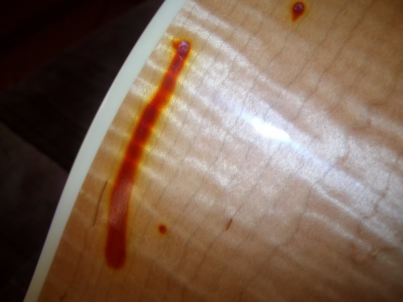

Just a nine year old munchkin named Spencer that was scared to death to tell me what he did. If he had, I could have cleaned it up before the damage set in. His dad made sure he was never allowed in the room again.. Friggin' shame, ain't it? Here's a pic of the back of the same guitar, luckily the mishap didn't happen on the back, but the lower waist where it happened, and on the top is bad enough :

Deft actually melts quite nicely into Gibson finishes. The trouble you may encounter here is matching the yellowing.
There are two ways to go. Spray straight clear and live with the "clearness" of it till it yellows, or get out your airbrush and spray tinted lacquer...............keep in mind the tinted will yellow as well, so over time will be "yellower" than the surrounding area.
People say Deft is crap lacquer............what do you think Gibson's is? Crap lacquer. It is all in the skill of the user.
Real nitro hasn't been used by Gibson in a long time.

to repair I would not refinish all the guitar but focus on the repair first. you can alway redo the whole guitar if you blow it. Start with 220 to cut down the finish then move to 320, do not press hard but but sand lightly try to remove the lacquer taco staining. Stop when you get close to the raw wood then move to a wet sand of 600 and 800 if you get the stain out before cutting into the raw wood your good you will be able to build up the finish and rubout.

What about trying a burn in stick Dave? And I wonder if there is a way of removing the discoloration without sanding. Maybe some food grade H202?? Have you asked the good doctor his opinion? As for Deft, I agree about the quality of that product. I used it all the time back in the 80's. Good stuff.
