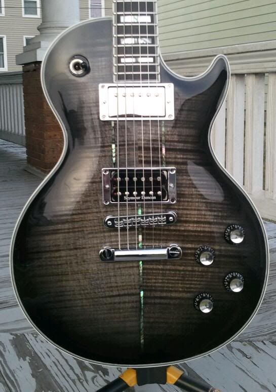

Ok.. lacquer cured, polished out and hooked up.
FREAKIN GORGEOUS.. This has got to be my favorite guitar to ever roll out the shop.
The action is STUPID low.. if it wasn't for the super sized frets, you wouldn't notice there were strings under your fingers it plays so easily.
The Fishman Peizo bridge works GREAT.. its set up with two jacks, one for the duncans with the ability to blend the Fishman into it and one for just the fishman. The neck tone control is actually the blend/volumecontrol for the Fishman powerchip preamp, When you plug into the second jack, it splits the signal and the "blend" control then becomes the volume for the fishman.. pretty neat system actually.
If you are installing a Fishman Power bridge, I HIGHLY suggest going with the power chip.. I've done 'em the cheap way by adding the buffer circuit to a standard pot.. but the end result is that there is a considerable drop in output from the piezo as compared to the mags. (Funny, one of the guys i contract to is far from poor,, ok hes loaded... but he wouldn't spring for the power chip until he actually heard the difference...)

Man I'm lovin' this build. I've always wanted to put the piezo in a Les Paul, because for
me, that would make it the perfect guitar! Your customer is one lucky fellow!!!!!

Stunning! Please tell me the limba neck/back/sides are still natural? The previous rear/side shots were amazing.
BillB1960
Jun 1, 2008
15,908
21,257
I really don't like trans-black guitars but that is one gorgeous work of art Shane! Kudos man! :thumb:
