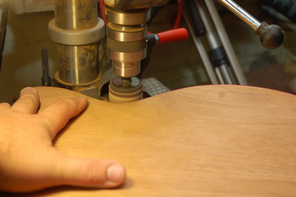

I have some work done - sanding. For this nasty job I used belt sander for outer curves and my drill press for inner curves.
Since the table is small and only hold by one screw is very important to set de 90 deg angle and checking very often during sanding.
It's not showed on this pic , but i used little wooden block under table to make it more stiff.

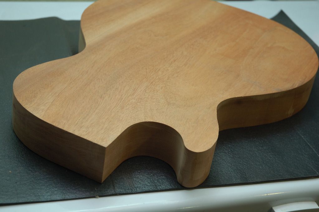

and the result
than I moved to my drill press
After couple minutes....
It will required some final sanding. Now i'm going to grab some food and rout cavities or should I finish for today and play guitar :hmm:

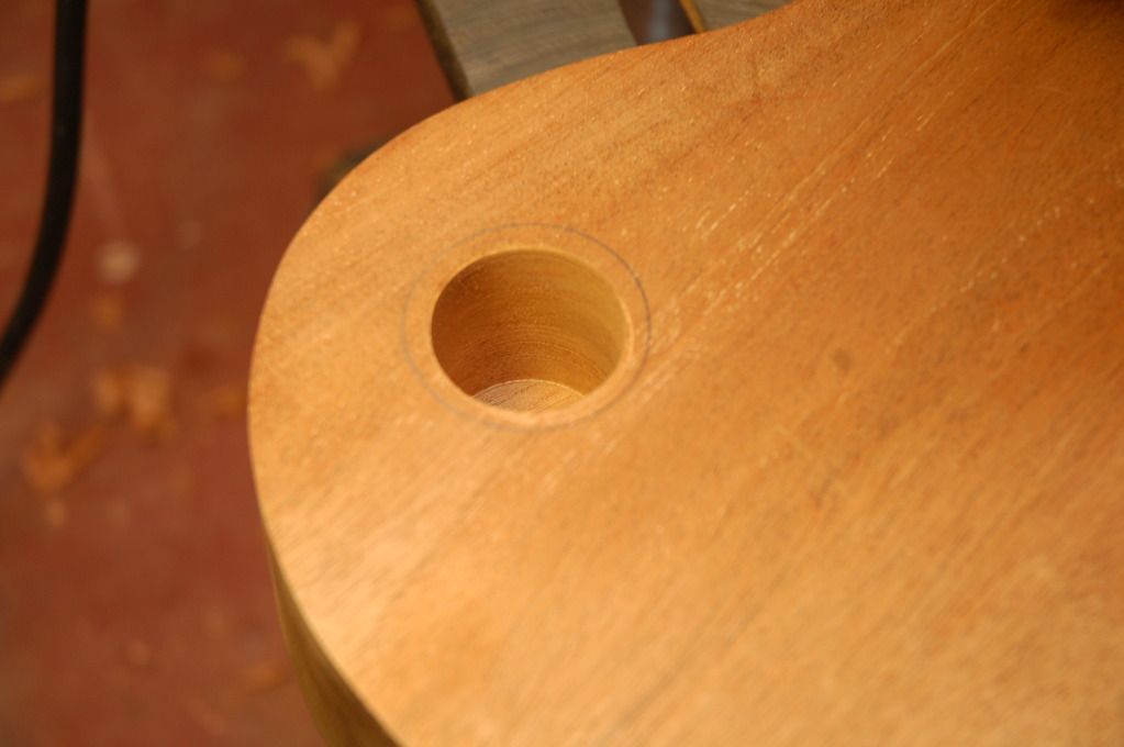

Drilled holes for cavities
That's it for today. Tommorow cuting and glueing the top. Stay Tuned.
