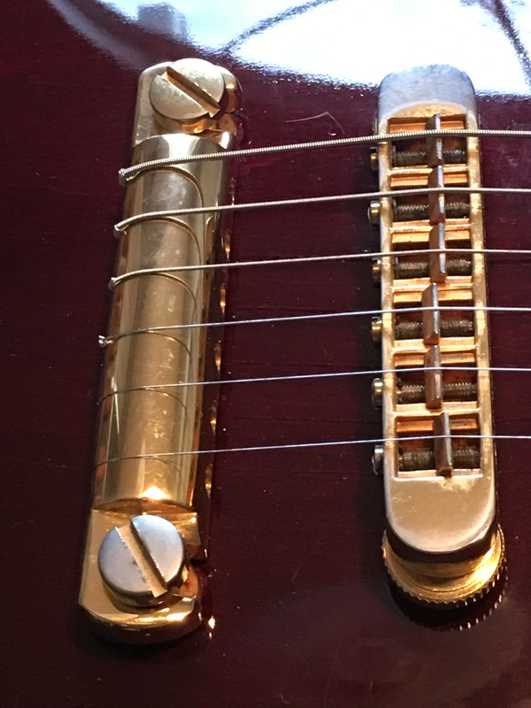

Yesterday was having one of my guitars dressed by my luthier, and LOL...he scolded me because I keep docking all my tailpiece down, and he showed me a box with a TONNES of bridges completely bent because of that. There was ABR1, Nashville, Faber, Gibson, Gotoh...seems just happening in any kind of brand or bridge. I was shocked really, 40 years of messing with guitars, and never thought of that. They were all bent in the middle, basically killing the 12" profile and aligning the saddles on a straight/flat line. This of course gives you random buzz across the fretboard, and a inconstant feeling on the strings, exactly the problem I was getting with this guitar. Now I'm gonna undock all my tailpiece and check all bridges...sigh
This is the bridge I had in this guitar;

I learned of reports of too much pressure from tightened stop bars causing a dipping in the middle portion of Les Paul bridges from another forum about a dozen years ago. I never had the screwed down bar on any of my Lestes. My 18 year-old Classic has had a “bent” ABR-1 bridge for some time, but it does not seem to bother the guitar's tone. I have lowered that tail piece just a tiny amount to stiffen the action for my preference.
There is a slight dip in the bridge, but the saddles don't seem to be down as much?!

I had a bridge collapse recently but it was almost 40 years old.
However, I've been thinking I should start top wrapping as well.
:wow::wow:
The pic in my last post is especially for @DarrellV!!!!!!!
:rofl::rofl::rofl::run::run::run:
Dude! You Top Wrap!!!! :wtf:
:rock:
I use the screws on the tailpiece that Teddy put there for that reason! Why re-invent the wheel? :dunno:
I also noticed the increased and to me, unnecessary downward pressure on the back of the bridge.
I saw no use in pulling the strings down across the back of the Nashville so I raised the TP till the strings cleared the back of it.
Recently I put a GF solid brass bridge on to cure the issues I was having with the Nashville, but I still like to leave the TP up a bit to take some of the downward load off the bridge studs and saddles. I like my strings a little bendy anyway, but I put 10's back on and so far the are still pretty bendy if needed.

Proof of damage caused by over-decking a tail piece!
Now I don't do it either!
