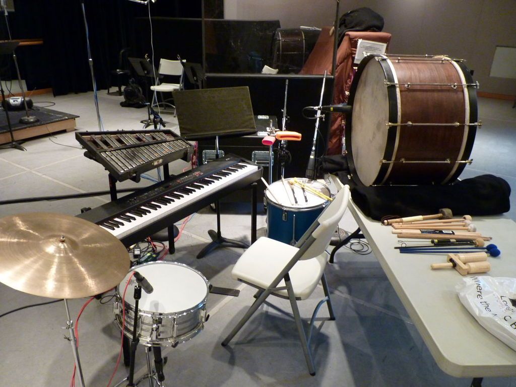

Next pic is the keys/percussion section. Stereo DI off the keys, SM57s on the top and bottom of the snare drum, AT4050 on the glock, AT 4050 on the woodblocks, Sennheiser 421s on the floor tom and bass drum.
Oh yeah....I thought the original cymbal the musician brought did not sound that good so he called up a friend who happens to live locally to borrow one...15 minutes later it was here....there's a lot of great musicians in this little town believe it of not! I got a pic of the underside of the borrowed cymbal:D
