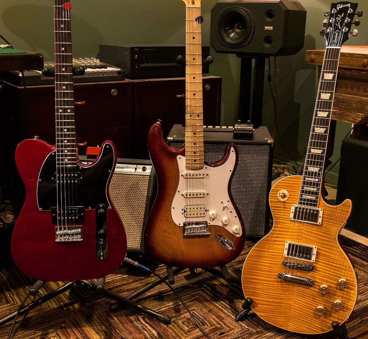

The Les Paul Standard in the photo above has a set of Burstbucker Pros in it which sound very good, but I'm leaning toward preferring the tones from the Classic '57 set.

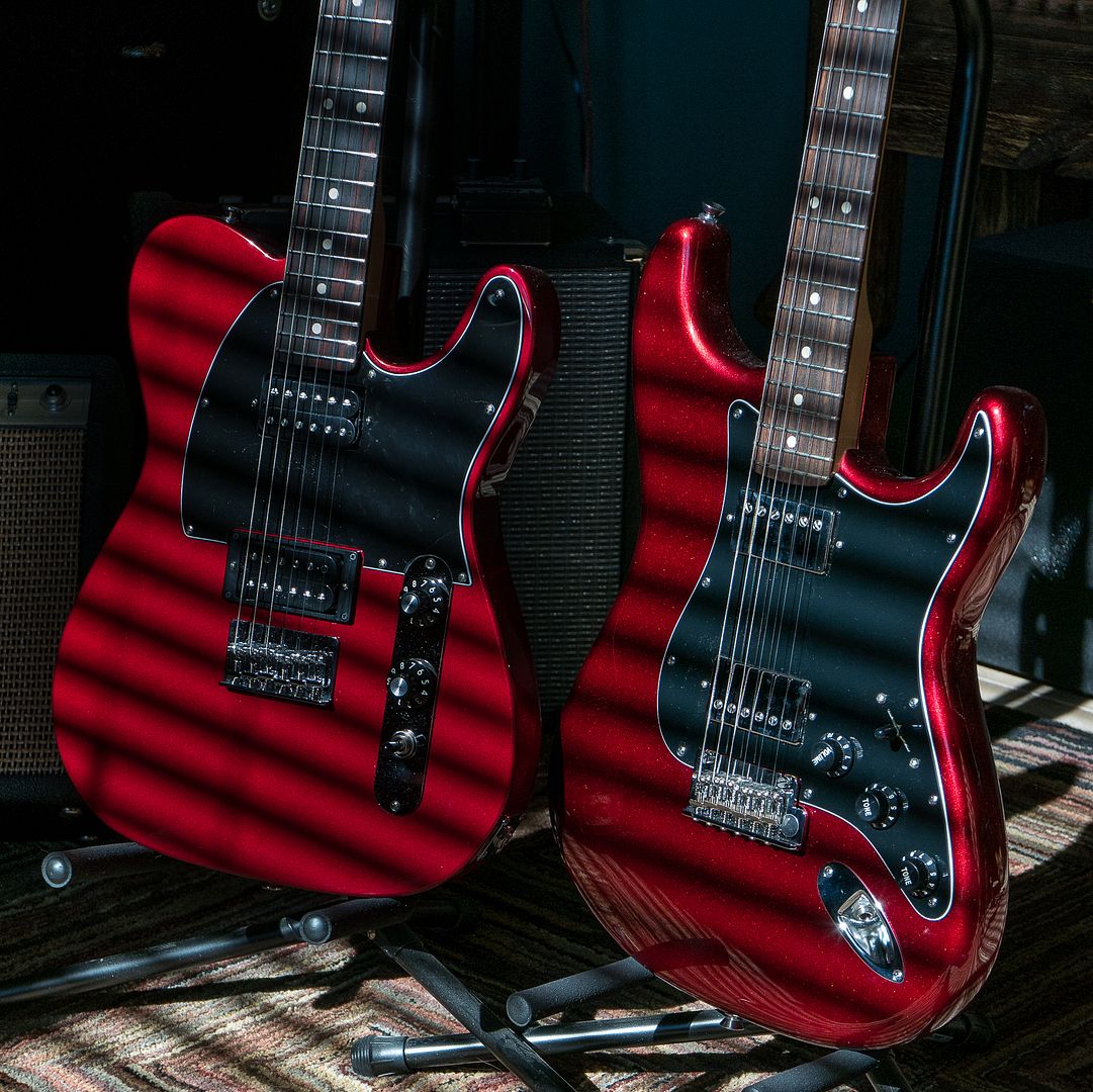

Thanks, everybody! I'm in tonal nirvana!
Gibson Classic '57s in the Tele. D Allen Alleycat PAFs in the Strat:
