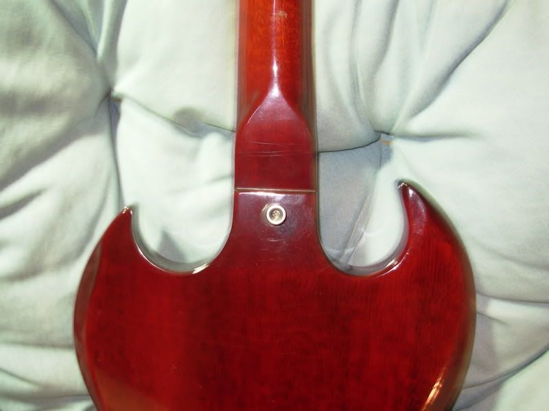

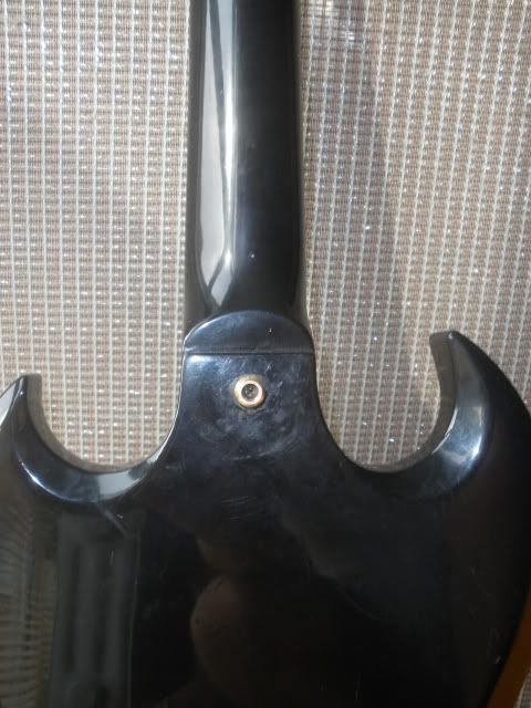

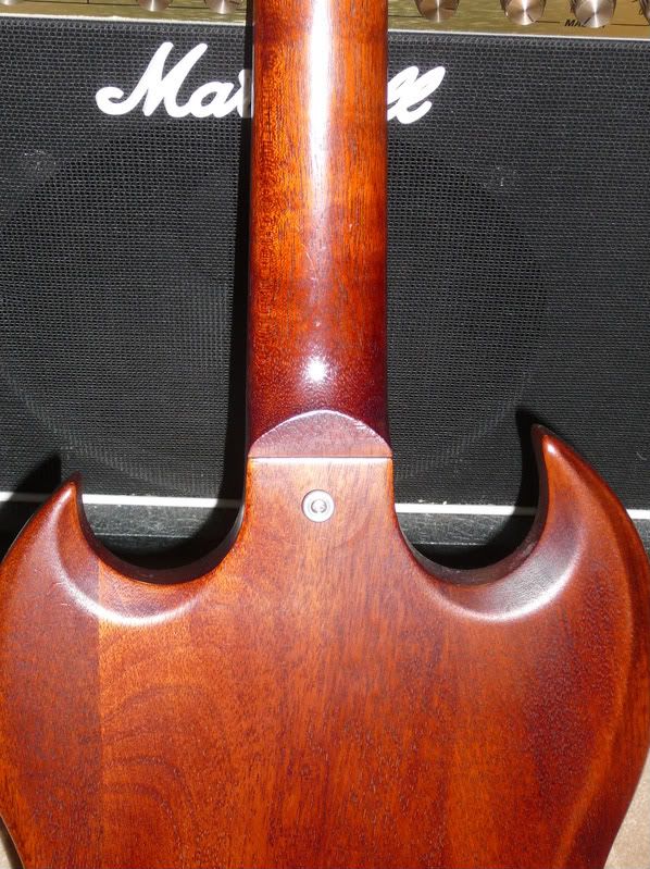

From my archives - some heel joint photos from some sixties SGs.
Hope these pictures help
1961
1962
1963
1965
1966
1970
62 RI
1967 Special
Contemporary special ('05)
1995 Special
1967 Special
SG Lou
Apr 3, 2009
2,676
1,838
1970 Standard
1961 Standard
1969 SG Standard

One doubt I own what I believe is a 65 sg special, but the heel joint looks like the 63, is that right? or what it could be?
Kevin James
Aug 22, 2010
1,516
1,170
Post a picture of the heel and the serial number range and we'll get it figured out for you.

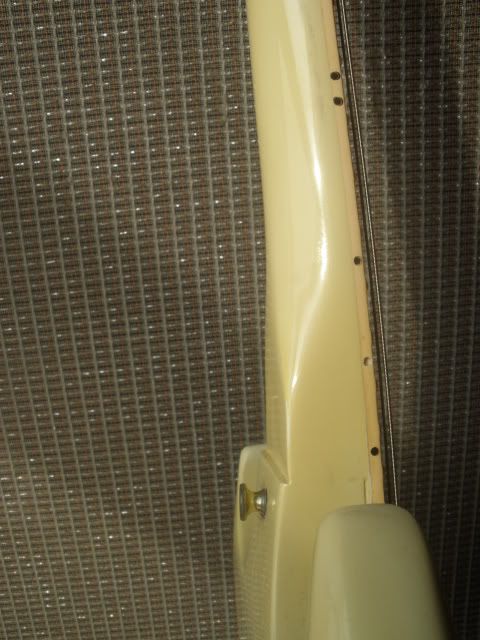

These a the pictures of the serial and the neck joint, and some others, thanks
Kevin James
Aug 22, 2010
1,516
1,170
Very hard to make out that heel pic as it looks like you snapped the pic from about 1 inch away LOL
Anyways, it is clear that it is a smooth heel joint and that along with the serial number puts that without question as a 1961.
