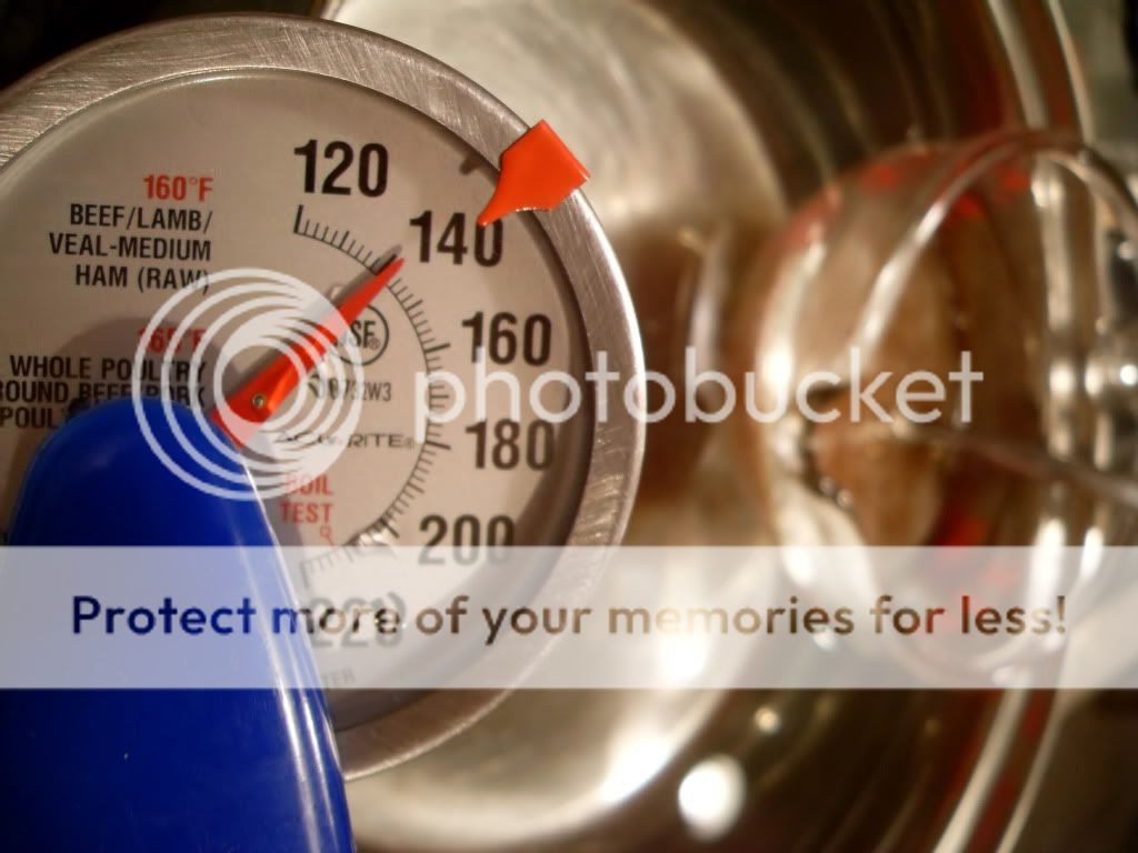

i paid 10 dollars for a small crock pot. on high it hits apx 145 degrees. i put a small amount of water in bottom and put a baby food jar in it with the amount of glue i need............which now is virtually none, because i use titebond for just about everything.

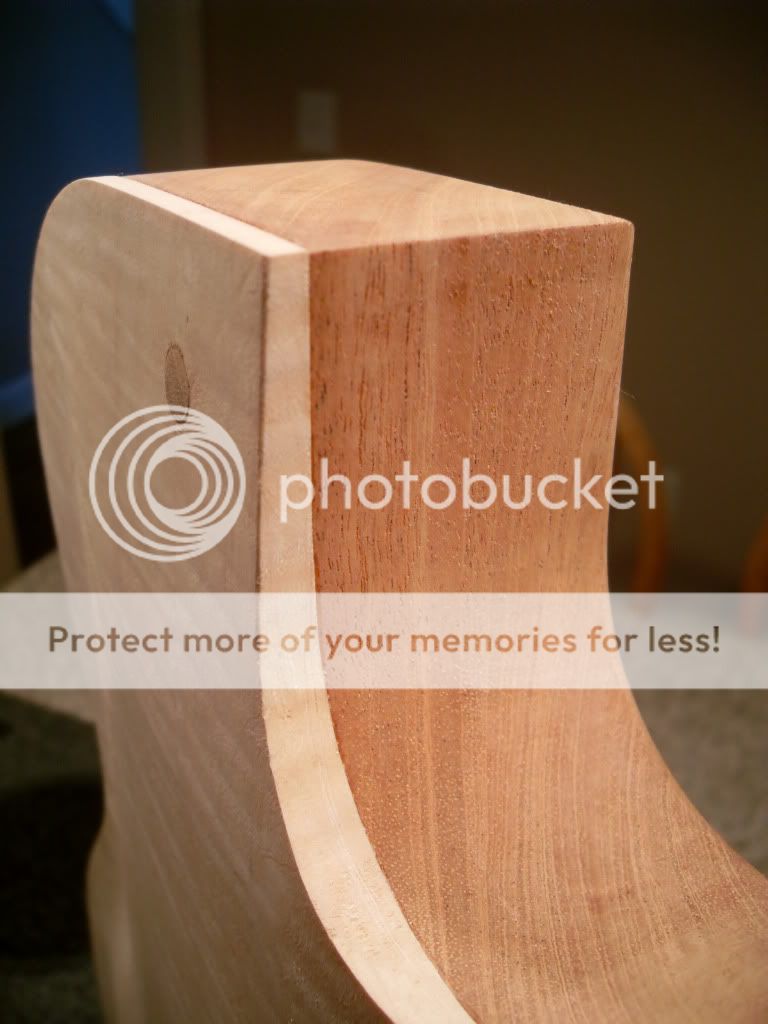

The following is how I went about gluing a precarved top. You may find it helpful.
Let's glue on a top.
Here you can see that we are now in the kitchen.
Everything is all laid out so that it is all within arms reach. Working with HHG was a little nerve wracking at first, but I got more comfortable with it after the third time.:)
The iron and hair drier were to warm up the wood so there was a little more open time.
I mixed equal parts dry glue granules with cool tap water and let it soak up all the water. After a while I began to slowly bring it up to 145-150*.
It takes a long time for the granules to completely liquify, and once they did I felt that the glue was slightly thick so I spooned in a little more water from the pot. Not too much though.
I had my wife help when it came time to warm wood, spread, and clamp. We did a couple of dry runs to make sure we were confident it our technique....Then we went for it!
These cam clamps are the best! They are so fast, and give a good bit of clamping pressure. We had it all spread (top and body) and clamped in under 1.5 minutes. My adrenalin was pumping. I didn't want to [email protected]#k this up!
And BTW the dowels IMO are undoubtedly the way to go! You just have to slide the top over them it takes ZERO time unlike using screws and a drill. That is a time killer.
The results
After trimming away the excess wood...
It looks good to me.
