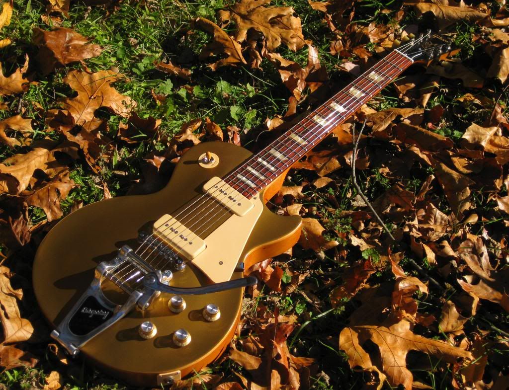

Finally got some decent looking shots today. The vibramate and B7 is a must have IMO for folks with multiple compatible guitars, add another 5 minutes to a sting change and you can add a bigsby or remove and go stock...no holes drilled:cool:
Here she is

I really love this guitar, she plays and sounds better than she looks too :cool:

You are one of the lucky ones to land the 50s tribute GT, nice. And the bigsby looks so sweet on it! Glad to hear she plays great as well. I'm curious how many pieces in the back? Beautiful photos by the way, she is definitely an autumn.

Really lovn that Bigsby Iceman! Are those pretty simple to install?

Really simple to install, just remove the stop tail studs,screw the dog bone plate where the stop tail was, attach the endpin plate to the bigsby, screw the bigsby down to the dog bone, screw end pin down, string and done.
Lew, yes, the dog bone and end pin plate have felt pads just like the actual Bigsby unit. Also note, dont go nuts tightnig the dog bone, its a straight plate on a carved top, I just went till I met resitance then backed up 1/4 turn, you want it to be able to rock slightly.

As long as you dont go nuts with the bar its pretty solid. The Kluson style tuners on mine are just fine....where you would likely have stability problems would be kinking/binding at the bridge.
A stringing trick I learned a ways back when I started using bigsby trems pretty heavily was a locking string wrap with as little string as possible wrapped around the post.

After a couple days play with the bigsby, it holds tune extremely well with intended use/dive bombs and such not so much (its not intended for those). It is a lot stiffer than the vintage B-12 on my epi sorrento or the import B60 on my Gretch Electromatic which is kind of odd to my mind, the B12 has the tension bar like the B-7, but both hollowbodied guitars have longer string travel than the LP...for some reason I was expecting the LP to be a bit more free moving than other two.
I highly reccomend the Tribute, I know they vary part to part....but honestly I would have a hard time doing a straight trade of my studio tribute for a standard of my choosing. She looks great, and really has "it" where it counts, tone and playability are perfect to me...nothing quite like a P-90 LP run through a loud, clean, Fender tube amp:shock::naughty::D
As stated the vibramate kit is well worth it, perfect....no its isnt, it could be a bit more tansparant if the main plate were thinner, and had polished caps over the main stud screws...but it still works great and for most...it is invisible...combine that with ease of installation and removal with no scars minus some possible finsidh fading....its a winner:thumb:

Thats what the vibramate is all about, its a plate/endpin plate that retrofits a stop bar tailpiece LP to a bigsby with no hard mods...you get tired of it or need to put it back stock to sell...it can be done in minutes with no trace aside from possibly some spots where the finish faded , and didnt where the hardware was.....
To put a B7 on without the kit, you'd have to first plug the stop bar holes , refinish or major touchup if looks are important....then drill new holes to mount the bigsby.....its a tall order for most folks.
