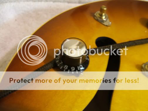

To start, you gotta get the old harness out. But first, before you go tearin' into the guitar to get the pot harness out, >think<: what could impede my progress?

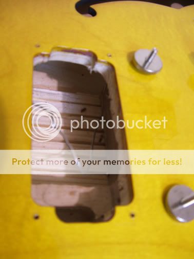

Yes, the ground wire. The ground wire is commonly soldered on the metal braid of the Bridge pickup lead. So, in my experience, it is best to remove this first. It is wrapped around the braid, and soldered on good, so you'll have to carefully apply your iron to melt the solder around the ground wire and kind of twist the pickup away from the ground wire. Easy to type, tricky to do in real life. Make sure you put your towels down on the top of the guitar so you don't accidentally drip solder or burn the top of your guitar with the soldering iron.
Once I get the ground wire off the metal braid, I stuff it down to the bottom of the pickup route, and tape it down with masking tape:
Now, time to get the harness out. Grab your High-falutin', Hi-Tech, Roswell Knob Puller (a.k.a. the shoelace), get up under the knobs, wrap once around, and pull ^up^ while resting your thumb on top of the knob so you don't shoot it across the room, like so:
Once you get the knobs off, loosen up the hex-nuts and the jack, and collect the nuts & washers and set them aside (don't lose them).
It will take some manipulation, but you can gently manuever the whole harness out.

If you've gotten this far, you can remove the Bridge pickup and set it aside. Don't lose it, you will need it later. :naughty: I like to leave the Neck pickup in the guitar--no real reason to remove it, but I tape its lead down with masking tape. Unless you are changing out your pickups, then go ahead on with taking it out.

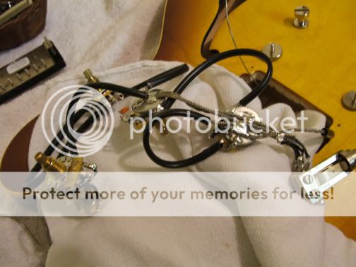

So, now you got the harness out. What a mess this thing is:

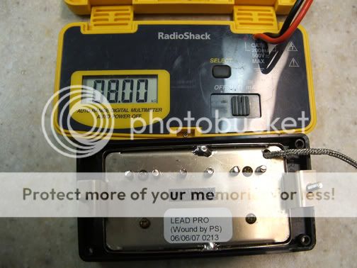

I always like to see what kind of resistance the pickups have in the guitars I work on, and my buddy Steve's 335 is no exception. Gibson chose a pair of BurstBucker Pro's to go in this beastie:
Note the dates of manufacture of the pickups... :hmm:

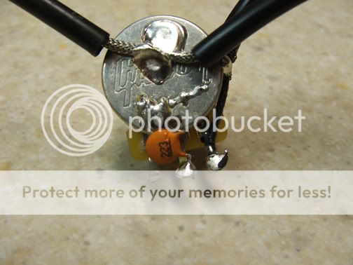

got Tone?
That cap needs some Viagra&#8482; :lol:

Alright, so we got that old harness out of there, and we didn't burn the house down. Time to prepare...
First, you've got your harness. Whether you bought it somewhere, or you made it yourself, please, please I beg you: test it before you install it. How? Hook your pickups up to it really quickly (i.e. "not permanently"), plug in a cable, and tap on the pickups, making sure the Switch, Volumes & Tones all work like they should. Take it from one who's found out the hard way, it sucks donkey balls having to install & then take out a 335 harness because it doesn't work, because something shorted out, or for whatever reason it's not working...
For this reason, every pre-wired RS Guitarworks 335 harness is tested at the shop, by me, to make sure that the Switch, Volumes & Tones all work like they should.

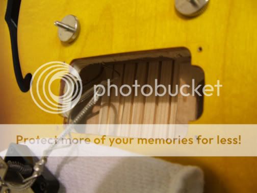

Just when you're getting ready to go for it, one more thing you need to observe: there are 2 kinds of 335-style guitars in this world:
  • Jack on the top of the guitar body
  • Jack on the bottom/side of the guitar body
If you have the jack on the bottom/side of the guitar body, time to get your Reachin' Stick/dowel rod with the jack plug on it.
  • Put the flat finish washer on the stick.
  • Put the hex nut on the stick.
  • Fish the Reachin' Stick (with the washer & nut on it), through the hole for the jack, towards the Bridge Pickup route.
  • Put the lock/'star' washer on the stick, and...
  • Plug the plug into jack of the harness.
You will use the Reachin' Stick to pull the jack through the side of the body, with the lock/'star' washer on the jack, and be able to screw the hex nut on top of the flat washer, all in one motion. :naughty:
If your jack is mounted on the top, then you have to get inventive. My way was to fish a long piece of scrap wire through the jack's hole in the top, and get it to the Bridge pickup route.
I then put a lock/'star' washer on the piece of wire, and let it fall down on the wire, inside the body. I then ran the wire right through the jack (like a plug), out the back and gave myself a few inches of slack.
I then tied a spare hex-nut onto the end of the piece of wire, so it is behind the back end of the jack.
Next, tie the other 3-ft or so length of wire to the hex-nut, so it is hanging out of the Bridge pickup route and outside of the guitar.
When you pull the wire out of the hole for the jack, the jack should be pulled right into the hole, using the spare hex-nut behind it as leverage. Slip the finish washer & nut on the top, finger-tight.
Then, use the other length of wire to pull the hex-nut & wire assembly back out the Bridge pickup route.

Then, into the appropriate holes in the top, fish the rubber/plastic tubing through the holes, and angle them towards the Bridge pickup route:
Pull each individual piece of tubing up through the Bridge pickup route, and put a lock/'star' washer over the end of it.
Then, attach each piece of tubing onto the matching pot's shaft, taking care not to cross the pieces of tubing. The goal here is to pull the tubing (with the pots attached) in a straight shot from the under-side of the guitar, up through the pot holes easily.
