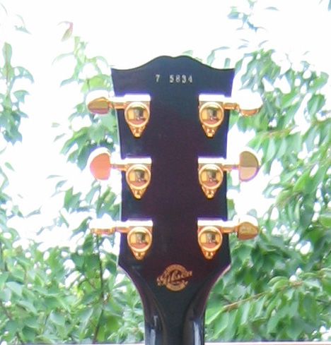

Sorry, my memory is fading as I get senile. I guess I thought mine was a '95. It looked like this:
SKATTERBRANE
Nov 26, 2008
21,430
12,406
That is interesting, what model was this Les Paul? Was it a goldtop? The color of the back does not look like the typical dark back.
I seems it might be a 1997 Custom Shop Les Paul, but I would need more pictures.

Oh, it is a Custom, should have noticed the larger headstock! I am not as well versed in the Customs. It seems that even the reissues had the Custom Shop decal on and off through the years. But this is the first Reissue Custom I have seen since 1994 with a Custom Shop decal. All the NON Reissue Custom Shop Customs have that decal though. Your case is 1999 or newer.
