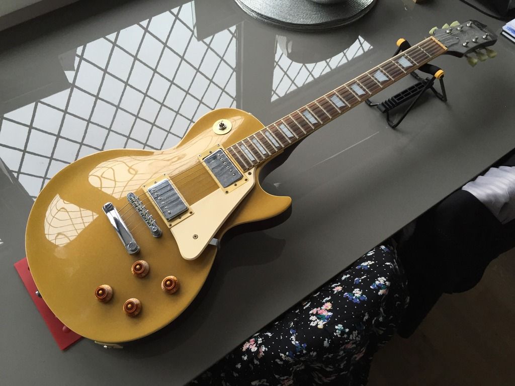

Pictures! So the guitar had been hanging on various walls for the best part of probably 10 years. Not only has it accumulated more than its fair share of dust and grubby marks but there's an annoying buzz from the A and D strings, most likely as a result of some 15 year olds (me) attempt to lower the guitars action.

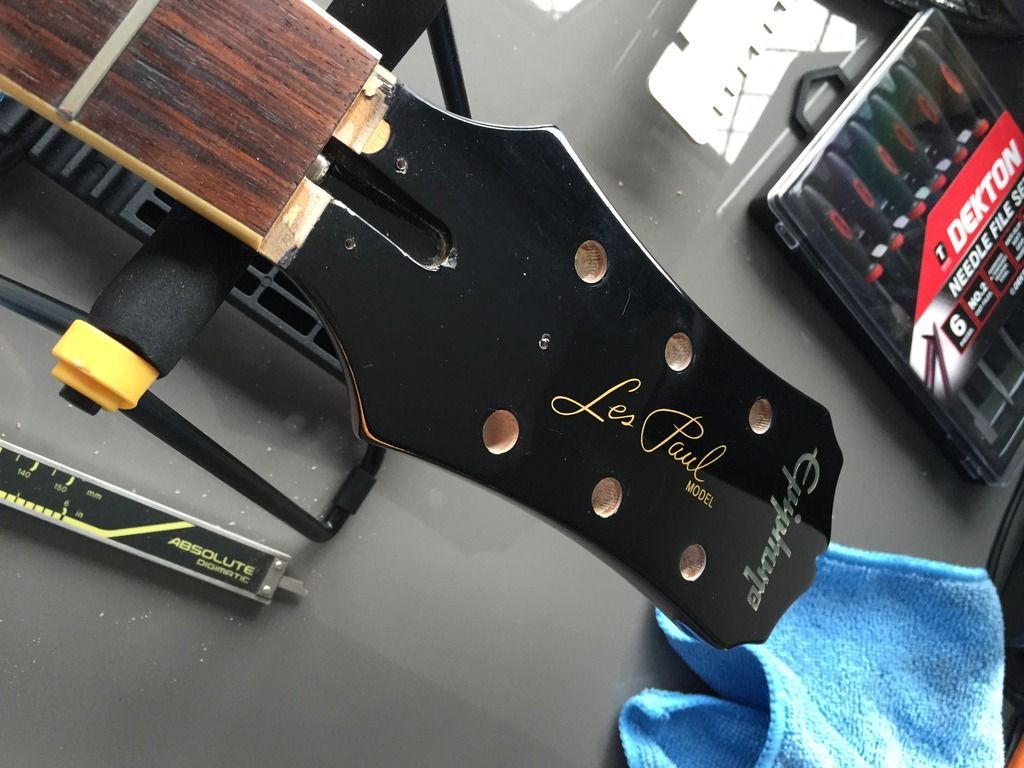

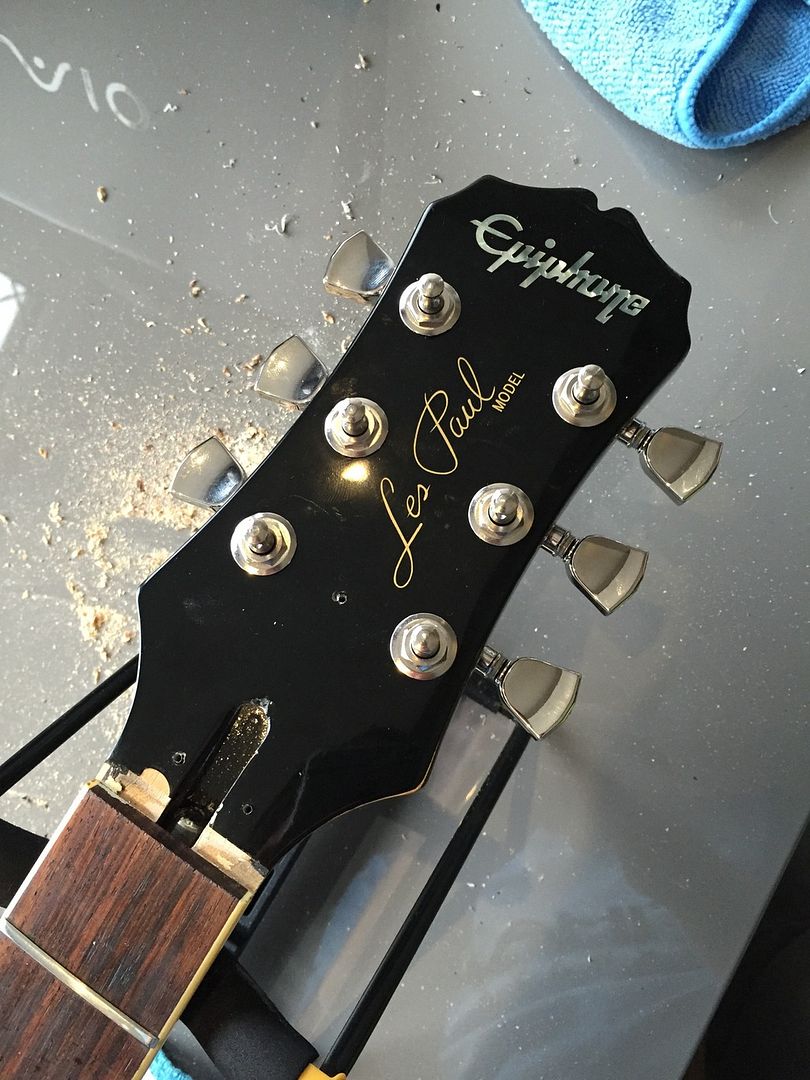

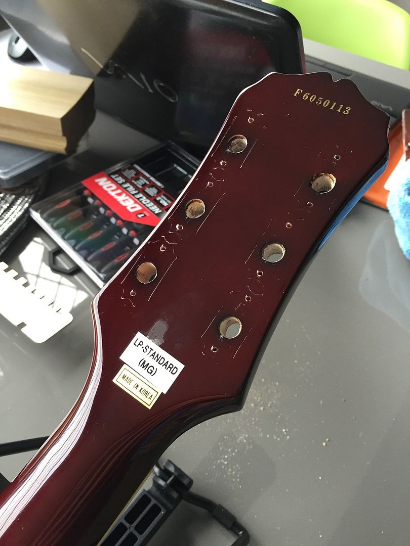

Does anyone have any idea what tuners these are? Im not mad about how baldy they've been installed so they're up for being swapped out. Suggestions on a postcard please.
Serial number info.

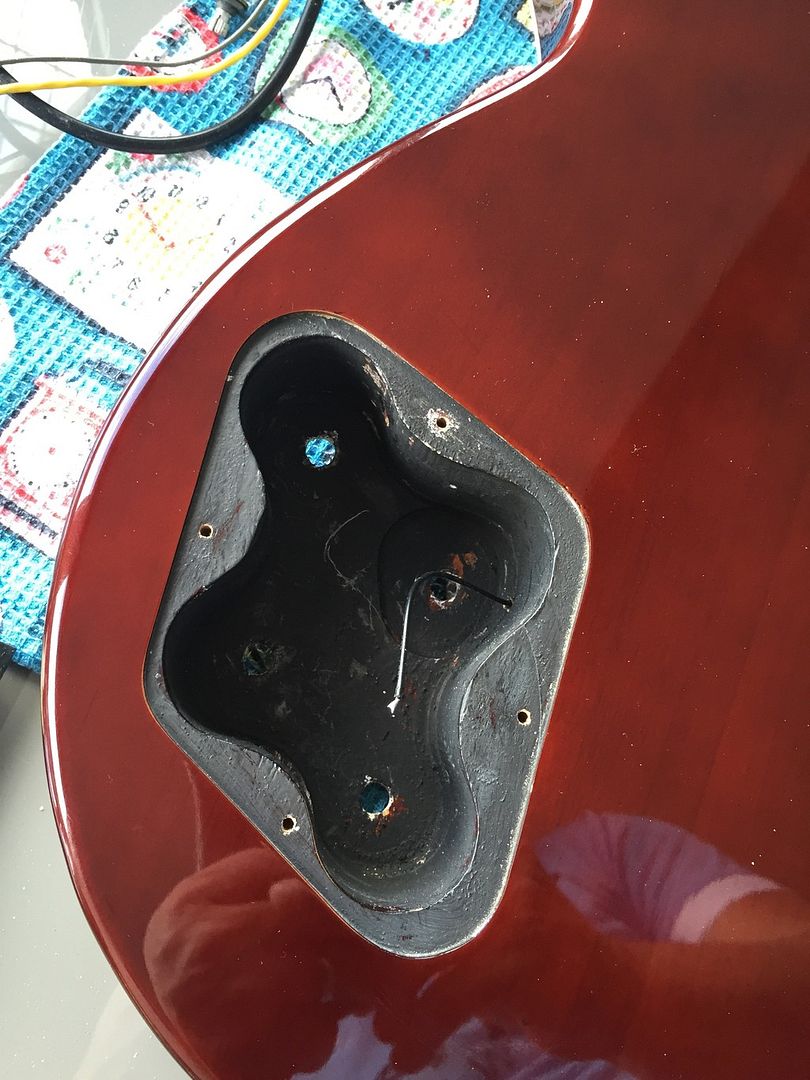

Tone/volume and 3-way covers off.

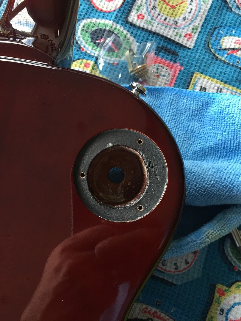

Jack removed, shown with Switchcraft replacement.
Pots and 3-way removed, looking cleaner already!
Pickups out.
First stumbling block. Truss rod cover screw rounded out by the afore-mentioned 15 year old.

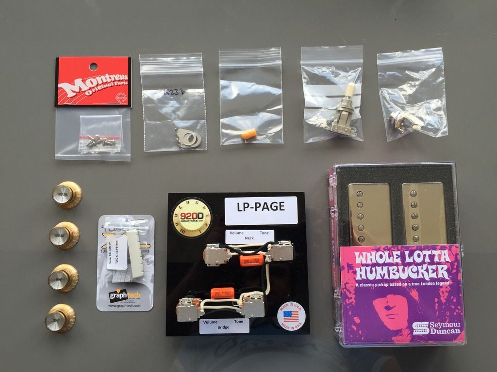

Plans so far are:
Seymour Duncan WLH or 59 pickups (nickel covers)
Page wiring mod, 500k pots, orange drops and Switchcraft 3-way
Switchcraft Jack
TUSQ Nut
Fret grind / polish
Truss rod / action / intonation setup
Tuners TBC
Plan is that this recommissions my previously unusable Les Paul, leaves me with a credible (for an Epi) guitar and I pick up some new skills along the way.

Tuners- no idea who made them, but I have the same ones on my 98 Epi SG. Lots of options out there for replacement if that's what you want. Or, you can just clean and lube these- my experience is well installed and stretched strings depend on a properly cut and lubed Nut- rather than tuners.

As for the tuners I guess they are made in Korea like the guitar, but probably too early to be Wilkinson. The alignment is proof of its' Korean origin :D
Similar type are made by Kluson, Grover, and Gotoh. Some are sold under the Gibson brand too - Gibson Deluxe tuners.
I think the key holes in the head are 10mm on that Epi, but you better check before ordering. I bought my Klusons at WDMusic in UK.

I had those tuners on a 1999 Standard a few years back, held tuning like a rock. Beautiful looking Goldtop.

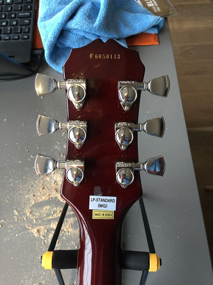

Thanks for feedback on the tuners gents. I am keen to keep them so will probably just elongate their mounting holes so their alignment can be tweaked. Yes it has a case now and it's place on the wall has been taken by a 2014 Alpine White Custom Pro that was signed by the guests at our wedding in May.

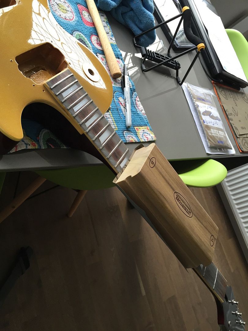

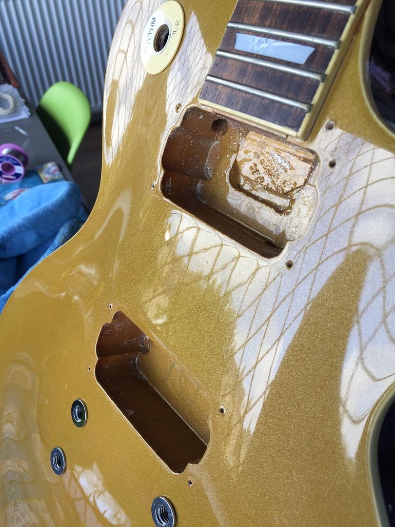

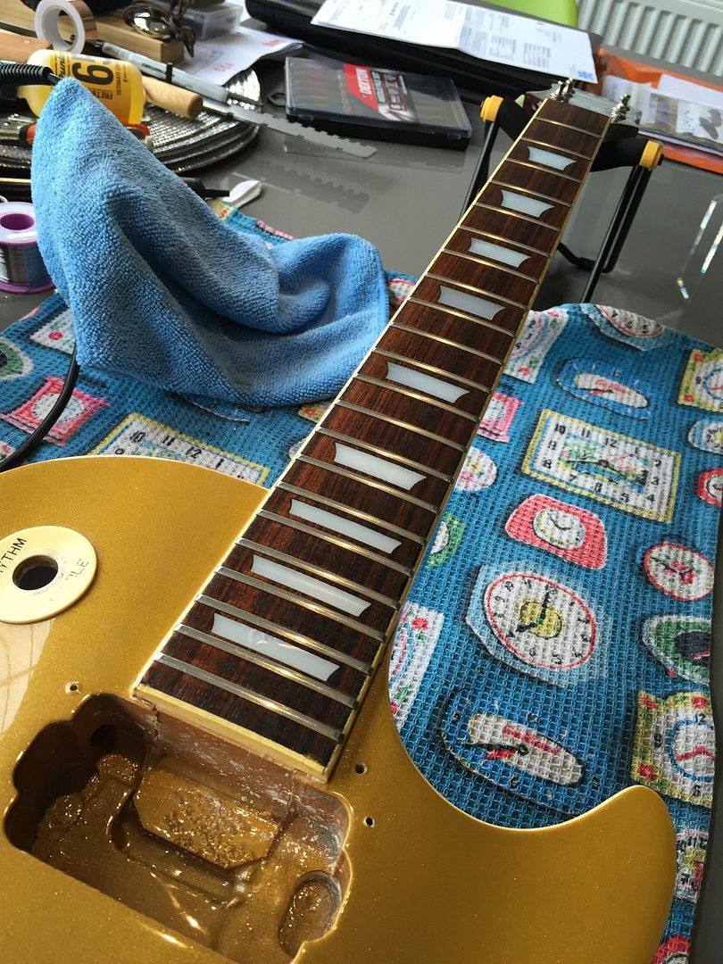

New soldering iron arrived so I removed all the electrics apart from the bridge earth. Also tried to clear out as much glue residue as possible from the cavities.

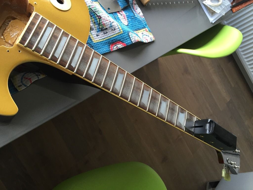

Trued up the neck as best I could with no tension on it.

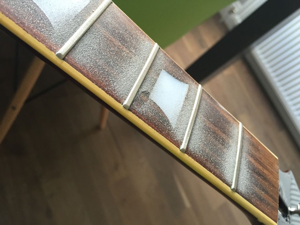

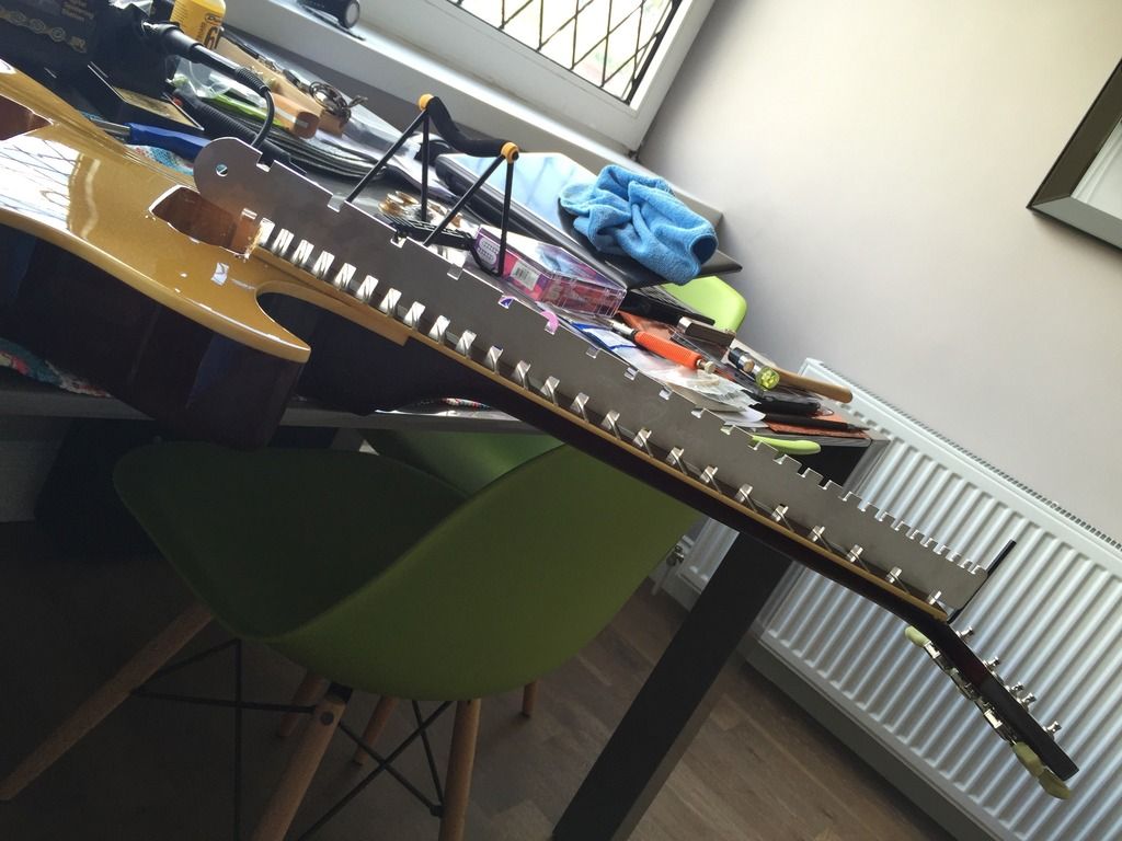

Very lightly ground down the frets although a fair bit had to be removed to level the G-B-E area on the first three frets photographed earlier.
Ended up buying a radius block and to be honest I wish I'd done the whole job with this. Also wish I'd masked off the fretboard.
Frets polished up with sandpaper and micro mesh - 14 steps for each fret! Then oiled the fretboard with lemon oil.
I mentioned I wasn't sure about the tuners and after shopping around a little bit I lavished the cash on some Grover Rotomatics. I started filing open the tuning peg holes but in the end I drilled them 0.5mm at a time halfway from each side up to 10.0mm which has resulted in a nice snug fit.
Managed to compromise on their orientation without having to drill any extra holes or file anything.
Currently waiting on some copper tape arriving to allow me to earth the body cavities before installing the electrics.

did you Crown the frets? they're very squared looking.

Love the Goldtop she looks fantastic after all these years :thumb:! Love the write up and all the pics as well, very nice. I am curious as Malikon asked cause that was my initial thought as well, did you you crown the frets after you leveled them?
