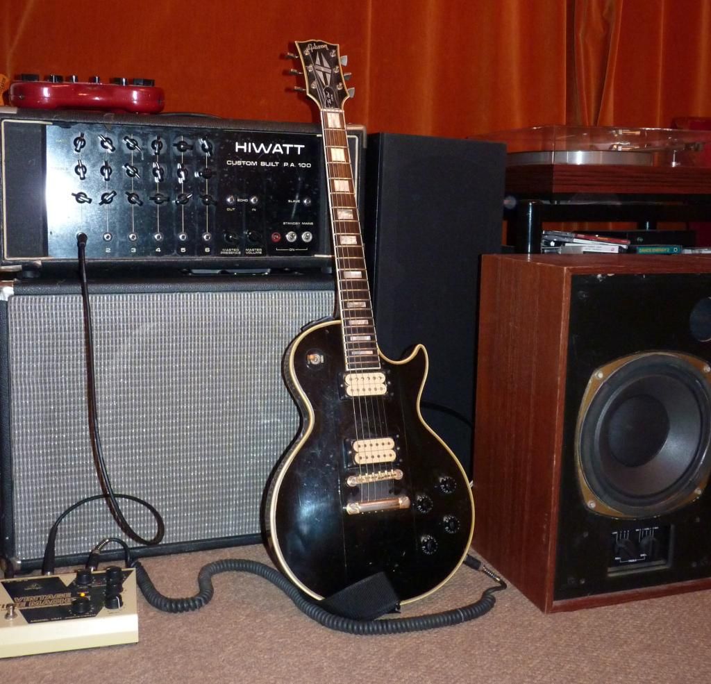

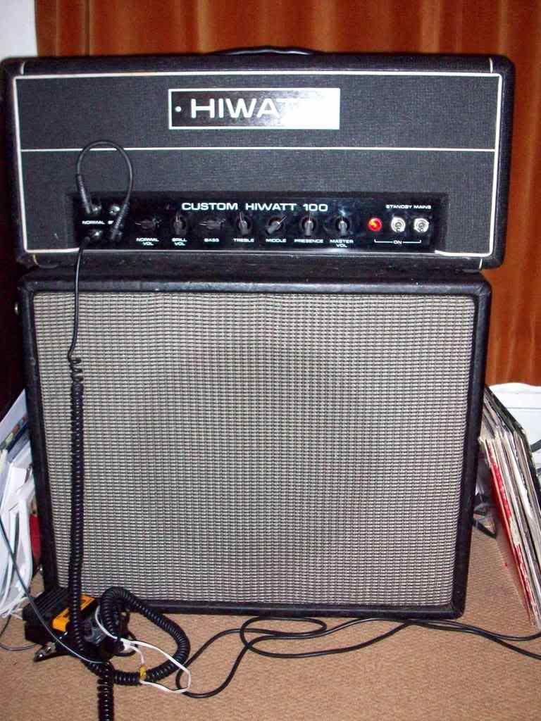

I just picked up a 1x15 cab and would like speaker recommendations .
I had a 1x15 cab with a Fane Pop 60 a few years ago and loved that.
Whats good?
The old amp and cab.
