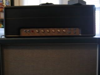

  12. WBPickups
    WBPickups Guest
    Nothing like plugging into a fifty watt with a great Les Paul....
    My new 50! Hand Wired Non-Master Volume.. I am so digging her!
    [​IMG][​IMG]
  13. bomberdrummer
    bomberdrummer Junior Member
    Messages:
    24
    Likes Received:
    0
    Joined:
    Apr 15, 2007
    Hey WB, Here's a pic of my 50 watt JMP Master Gain.....74 or 76 I think....Gotta love them Marshall's.:applause: .......[​IMG]
  14. WBPickups
    WBPickups Guest
    Your amp brings back some memories of my best friend who past away years ago. We were in a band together and that's what he played. It looks a lot like his old one. Broken "M" and all (his was missing the ll's too).. He had his initials painted on the sides of his. I still remember it like it was yesterday... "RS" painted on the side and cigerette burning on the top of it... Playing Aerosmith, Zep, Thin Lizzy songs.. That was great times! I bet that thing rocks!
