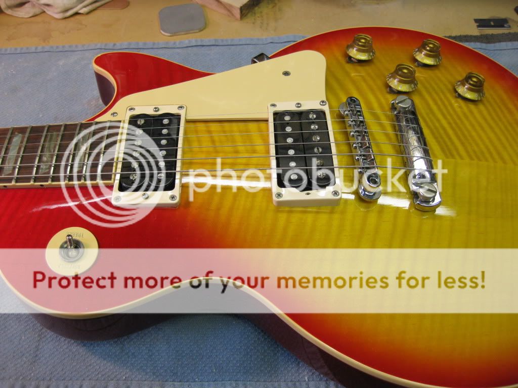

    The Les Paul arrived, loved but in bad shape. Cracked headstock, green inlays, worn frets, electronics issues, etc.
    [​IMG]
    Doesn't look too bad? Lets look closer. The bridge studs are all wack!

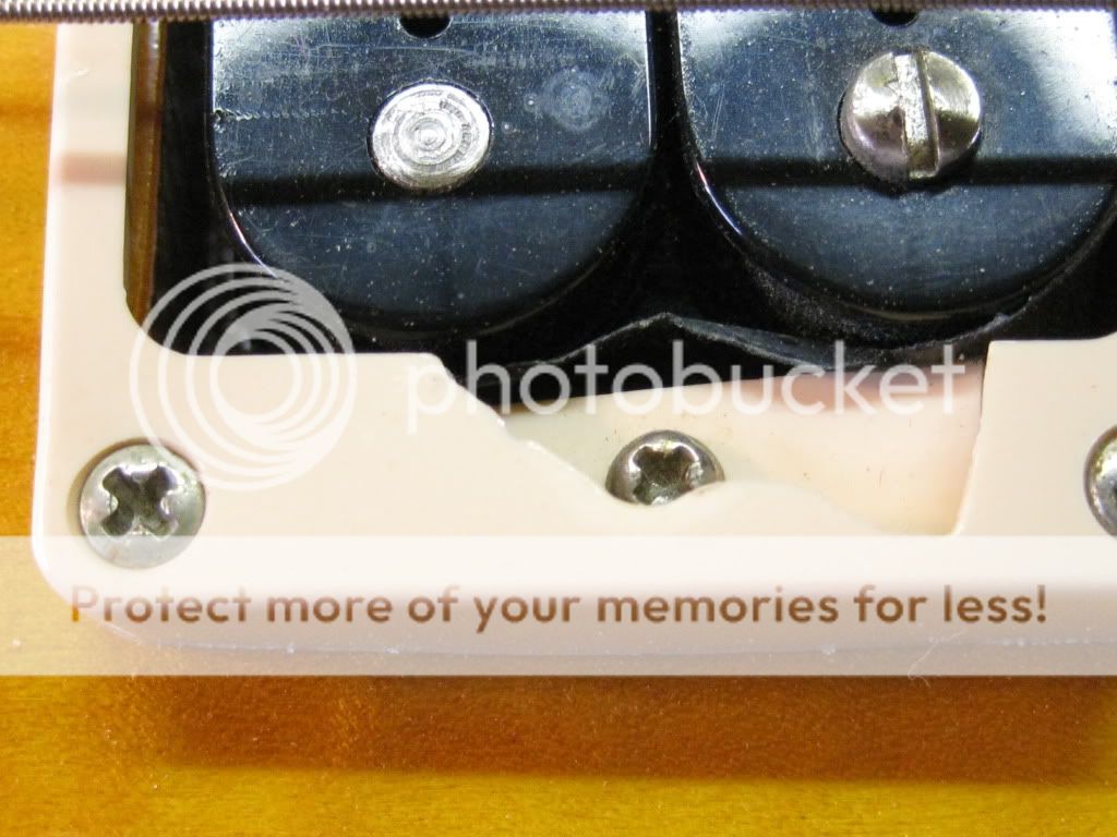

    The bridge pickup was collapsed. (shipping damage??? No evidence of that on the box or case)
    [​IMG]

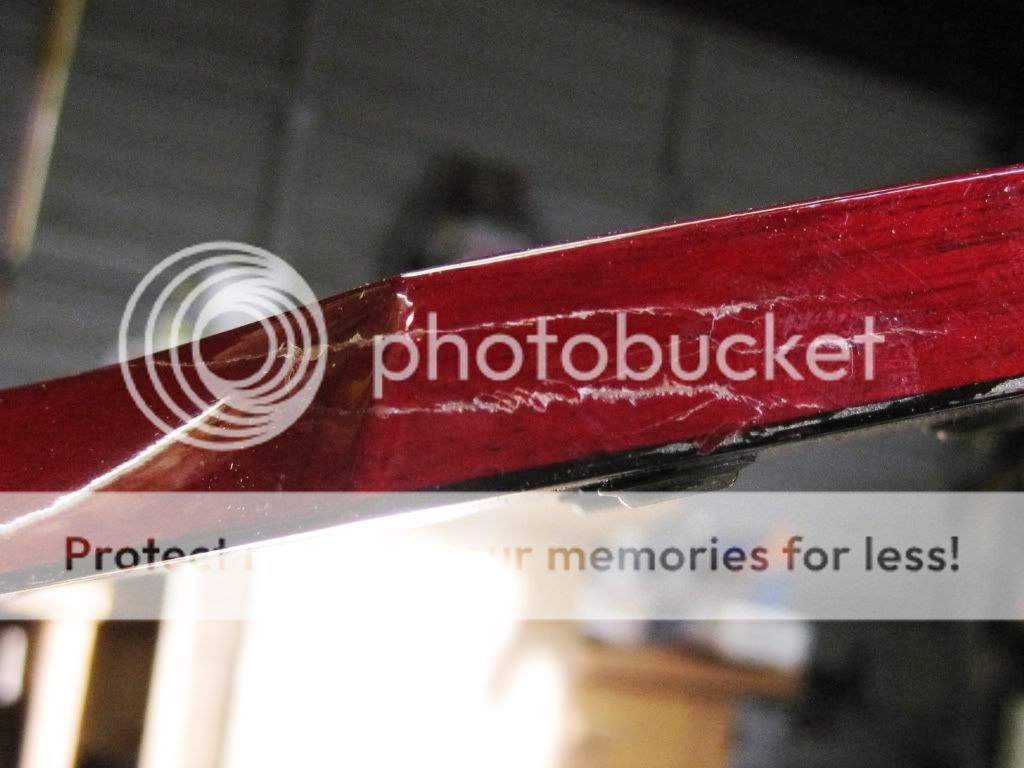

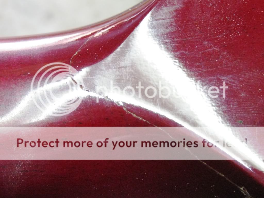

    cracked and previously repaired headstock
    [​IMG]
    [​IMG]

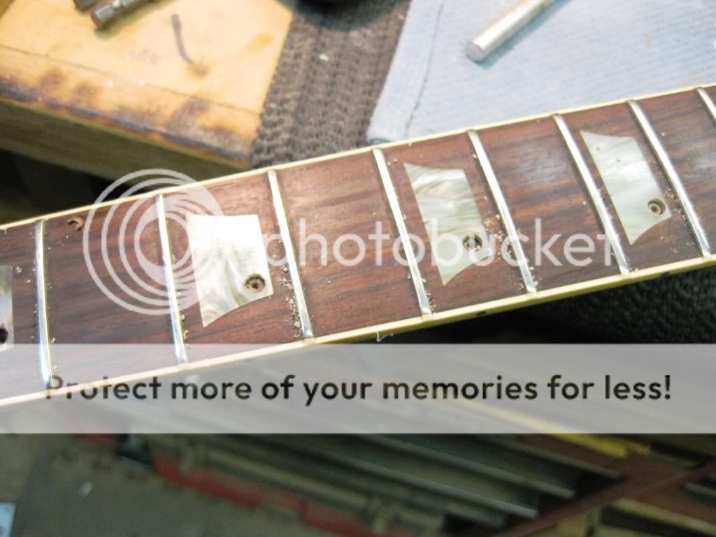

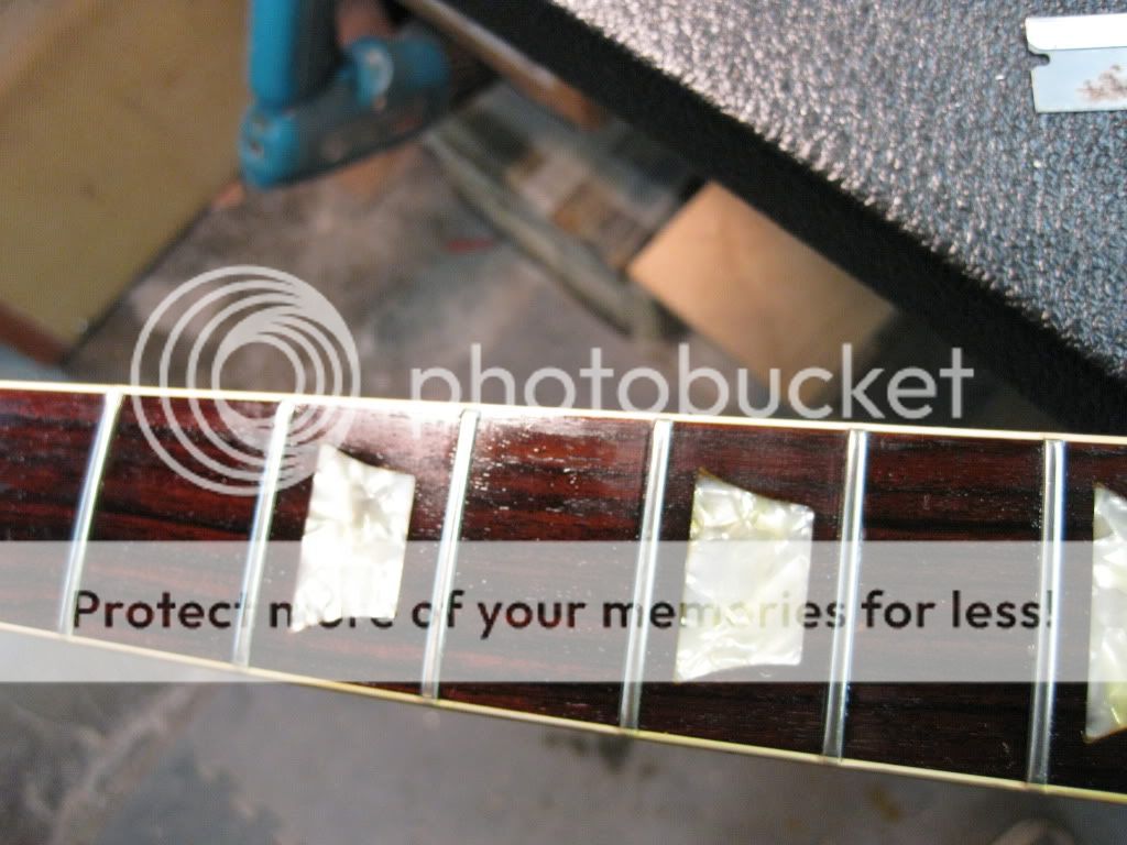

    Oh, We cannot forget the NASTY green inlays that had turned kind of black!
    [​IMG]
    Well, there we have it............time to go to work!

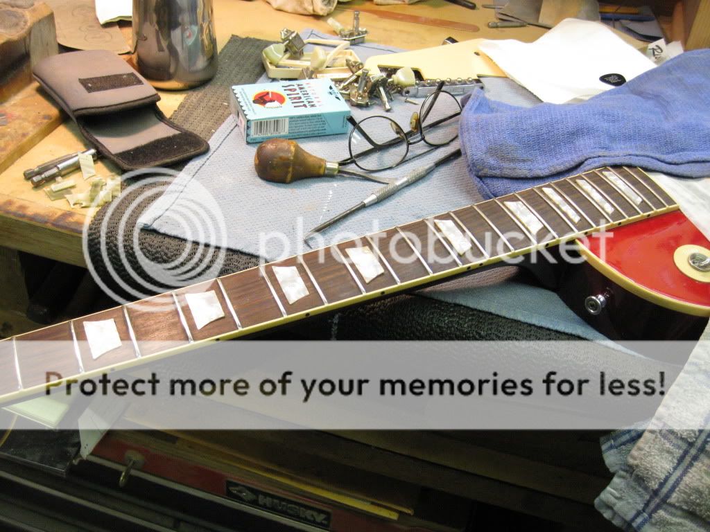

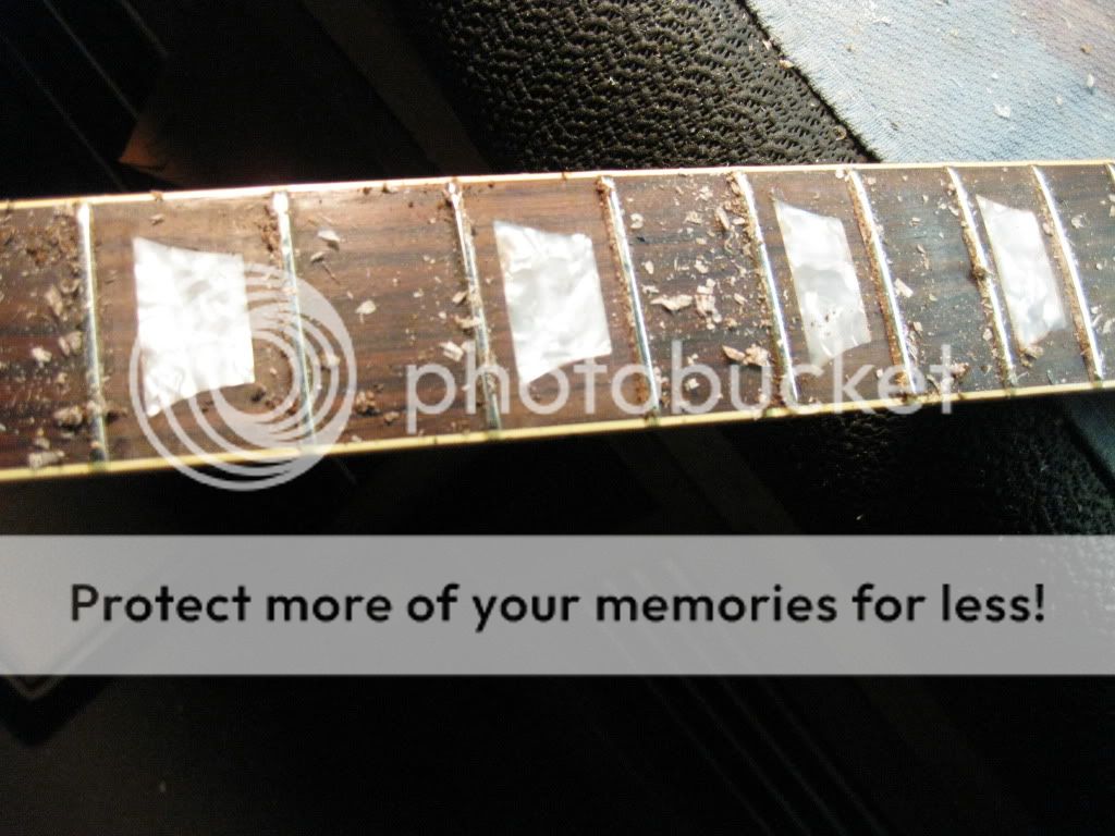

    The first thing after taking the strings, mounting rings, bridge and tailpiece off, is taping off the pickups so they do not accumulate gunk.
    Now I start.

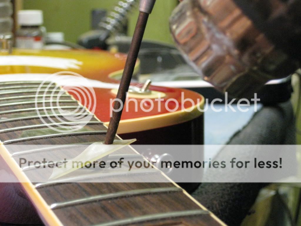

    With a brad point I drill through each inlay.
    [​IMG]
    [​IMG]
    I use a heat gun to soften up both the inlays and the nasty green glue that they use.
    [​IMG]
    This glue is NASTY stuff! It is a bit green which may attribute to the inlays turning green..who knows. All I know it has to go!
    I insist you use a heat gun, if you are going to do this to your LP classic. If you don't, you run severe risk of damaging the F/B with pull out of the rosewood.
    After the inlays are out, with an exacto, micro chisels, dremel or what ever you have to approximate these tools ALL the old glue needs to be removed.
    Here again Heat helps to soften the glue.
    Sorry I don't have pictures of every damn step, I got tired of taking them.

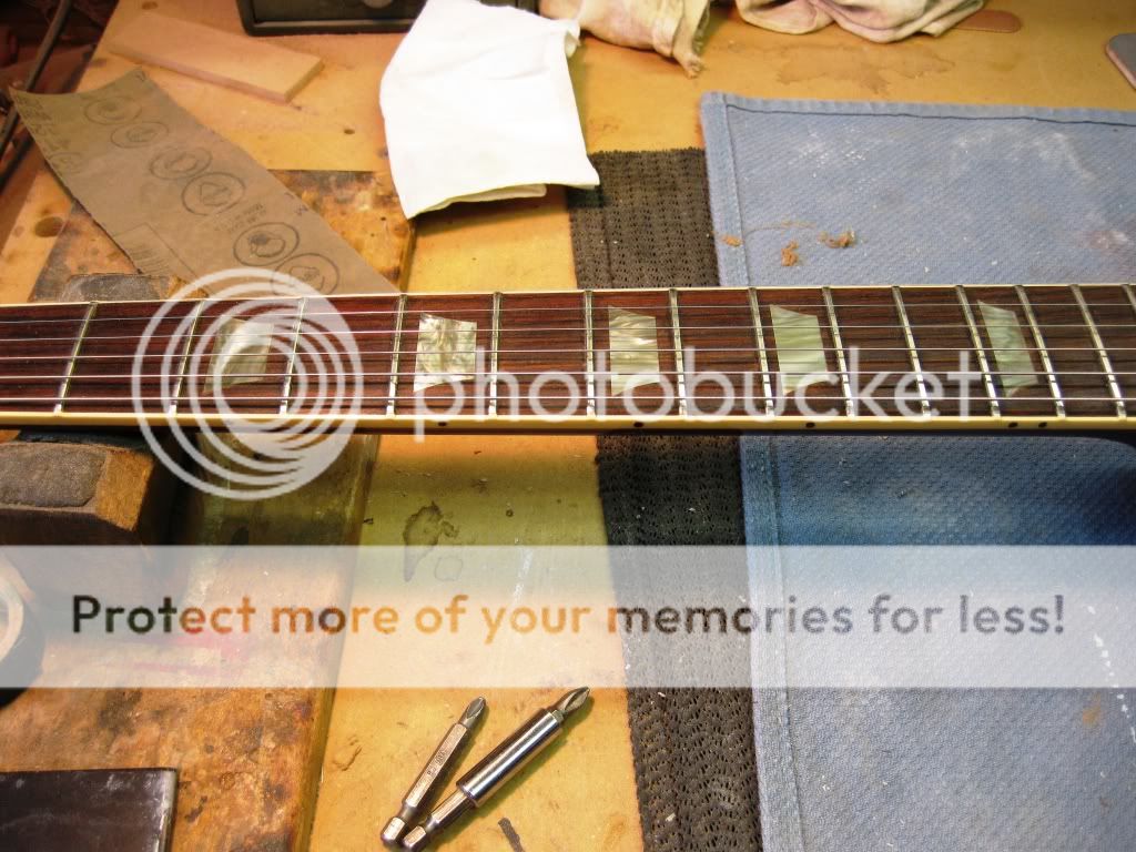

    Now we are ready for new inlays.

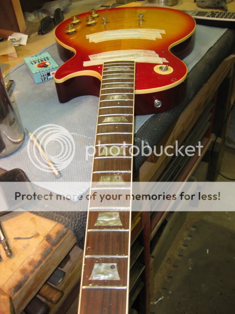

    Here I have got some new celluloid plastic laid out on the F/B.
    [​IMG]
    Instead of The nasty Green glue, I have mixed up a batch of 2 part epoxy mixed with rosewood dust.
    When ever I sand a fingerboard, I always save the dust. It is beautiful fine dust with a million and one uses.
    I now have the new inlays glued in. With a blade I scrape the inlays flush to the rosewood.
    [​IMG]
    We are coming along.
    After sanding the inlays and board smooth, I hit the board with a coat of oil.
    [​IMG]

    The headstock "seemed" solid but I opened it a bit anyway. Some hot water and creative clamping did the trick.
    I then re glued it and sealed up the cracks with some CA (superglue).
    I sanded smooth the break area and had to redo the color.
    Boy I'll tell you I was very surprised, that Stew Mack rattle can stuff is a dead ringer for the Gibson cherry color. I just misted on several coats till I got the depth I wanted, then did my normal clearcoats.
    I then hand buffed it out to match the patina of the rest of the guitar, and we're good to go.
    [​IMG]

    Here is a done shot.
    [​IMG]
    The guitar is on it's way to the owner I hope he will enjoy it.

    Very nice post Roman! One question I have. After you filed the frets, do you sand with a radius block?
    Thanks again.
    Sincerely, Scott

    Just one question, how do u know how high to make the nut and how deep to cut the slots?
    I also noticed on your initial assesment that you did not pick up on the gastly choice of colours that the guitar has been painted with!!!!!
    [​IMG]
    EWWWW!!!!

    No one is going to shoot you down. Remember in the first lines of the post I stated there would be some that would ask "What the hell is Roman doing":laugh2:
    DeoxIT is very good stuff. I have used it. I also have a background in Electronics including high tech military flight simulators.
    Here are some of my points of view on guitars. It ain't rocket science. I also have 30 some years experience in the real world working on guitars.
    Unless it is a "Vintage Valuable" pot, Big deal, it is a Pot.
    A pot is a mechanical device prone to wearing out anyway. Just like the brakes on your car. Pots are also cheap. So when they go bad throw them away. It is no big deal.:)
    I have found though repeat clients that cleaning out a pot with contact cleaner has no substantial effect on the pot wearing out faster. Also, if you notice on the can it has lubricant as well.
    With WD 40, I have found, that although it does work for a short time, it tends to gumm stuff up.
    Now vintage pots, well, there is a whole other science to get them good. I don't want to reveal to much. :naughty:

    To answer your question, I am my own "radius block" :laugh2:
    Seriously, I just sand with regular rubber blocks going though the grits. I have a couple of longer blocks I use as well.
    Here, I am going to show some age :)
    I have been doing this since before Stew Mack had stuff like that, one learns to use the tools he has.
    Us old timers in this field NEVER had available the goodies you guys have now, nor the internet
    On most of my builds I do all the radiusing on a belt sander, only to use the radius blocks for fine sanding.
    One trade trick I picked up along the way, is to do a slight compound radius in the frets themselves. It's all in how one uses the tools.:)

    The cherry sunburst, or as some call the clownburst, is not my favorite finish either, but Gibson has sold quite a few "classics" in this color. For many they are quite happy with this finish, and love their guitars.
    In my profession my job is to fix what the client finds undesirable and not to criticize their tastes.
    I forgive your criticism, and will answer your question:thumb:
    The rule of thumb on nut height is this;
    If you fret the first fret, measure the distance between the string and the second fret. that distance should be the distance from the string to the 1st fret.
    Make sense? In other words, the nut is kind of like a ZERO fret.
