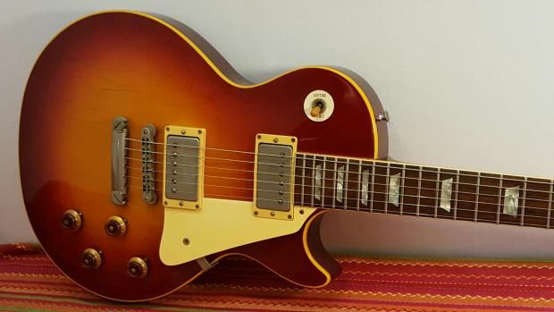

    I'm bringing this thread back from the dead, because it seems that not all MIK Greco Customs were made with ebonite fretboard! Here is one that Bat*** is currently selling, with rosewood (?) fretboard, normal size inlays and little different pickup baseplates!
    [​IMG]
    [​IMG]
    http://i1150.photobucket.com/albums/o605/vonserke/greco lp/s-l1600 3_zpsvmnm9wxu.jpg
    http://i1150.photobucket.com/albums/o605/vonserke/greco lp/s-l1600 2_zpsuv1tbgry.jpg
    http://i1150.photobucket.com/albums/o605/vonserke/greco lp/s-l1600 1_zpsnvl4qadg.jpg
    Carry on gentlemen...
